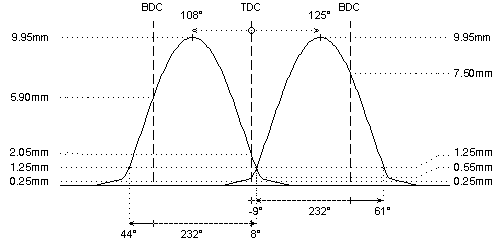

I am super pumped to announce that.... I HAVE ORDERED NEW CAMSHAFTS!!
I have chosen CAT Cams 3702606 jobbies: http://www.catcams.com/portals/0/pnplot_files/3702606.png
