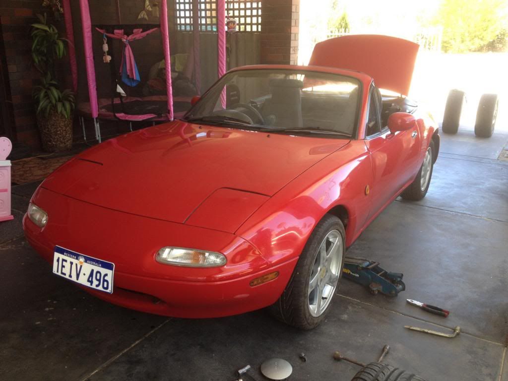

Hi all, went and bought myself a 89 na6 with 268,000 km on it. yeah i know its a lot but for 3800 its not bad. within half an hour it had lancer mags n tires on it. Look good but has a lot of backspace so a bit of neg camber on rear but will keep an eye on that. my big concern is it may have a leaking head gasket as we went for a drive up the hills today and she was bubbling nicely when we stopped up top. Got home and can see very small bubbles in rad so hope a retorque n rad flush will sort it out.
got to check out front pulley bolt tension as it looks a bit wobbly. so far love my little red noddy car

Hi guys , yep i know all about wobbly crank syndrome.... fixed a couple over my time as a car mechanic. ripped rad out tonight and gave it a power flush so will see how that goes with the last of the warm days coming. looks like it was replaced at some stage with a alli one but someone has painted it :frown:
been getting used to how it sticks in corners and wow,its a bit like a gokart you think you are at the limit but wait theres more grip to be had push harder!!

well a little update. pulled rad monday night and power flushed it out. not much crap but saw a little, test drive and seemed ok temp wise.
SO on my way to work the oil pressure slowly dropped and dropped,GOD WHAT NEXT............ so tonight i changed filter,filled with some diesel 15/40 and a dash of thick morreys additive . so far so good. pressure seems higher cold and holding warm. I think it had a stuck relief valve this morning as it was ok for the drive home after work.

HI GUYS n thanks for the rad loan offer but gave it a good power flush and it looks good in condition. guildford to midvale with a/con on,stop start driving and all good , temp was 34 or there about. Sat just under half.
Also oil pressure drop problem cured with a new filter n 15/40 diesel oil with a good dose of morries addative.

So tonight i put standard wheels back on as didnt like the ride n noise from the wide tyres/rims.
next is an oil change in box as probably hasnt been done in 268,000 km.
