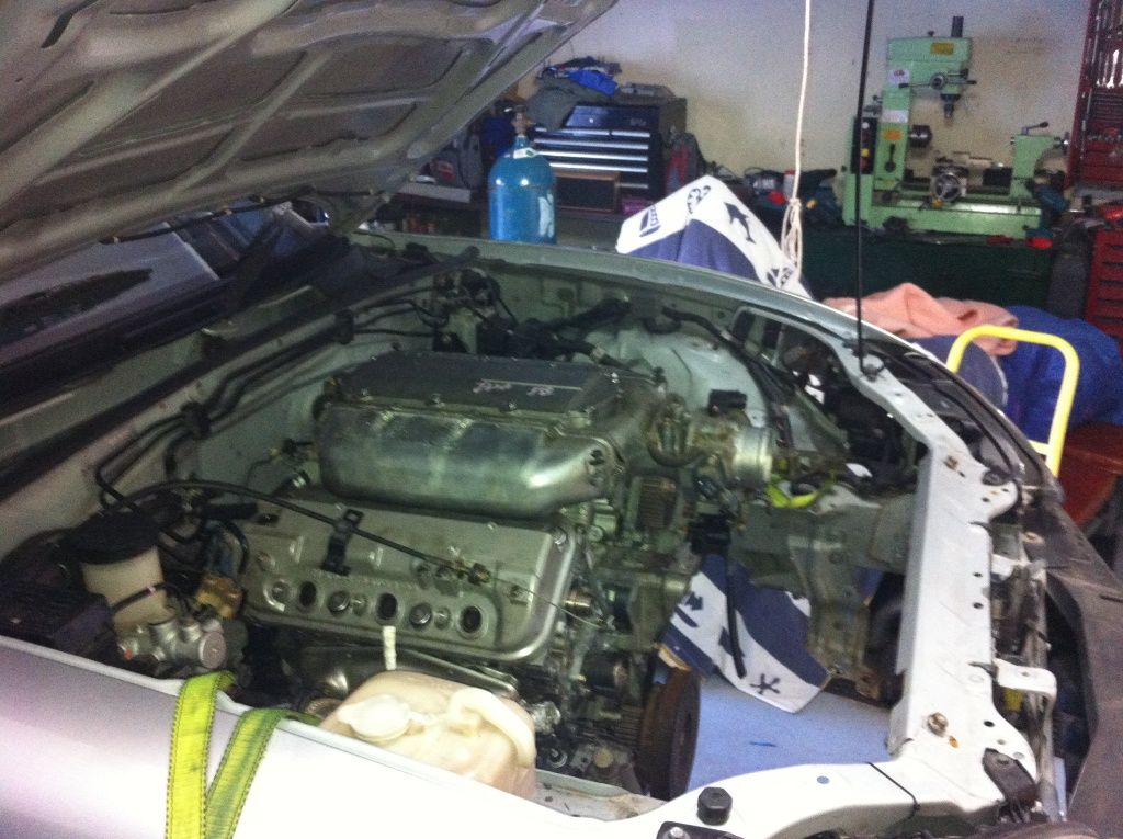

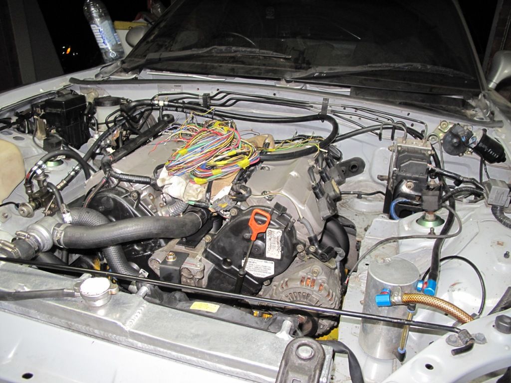

I have uploaded my raw camera footage onto photo bucket. 2 folders, Canon camera and iphone photos. Heres a couple, If you want to see more there about 800 photos all up, start with the iphone folder and sort it by "oldest first"
Enjoy.
In the beginning
http://i148.photobucket.com/albums/s21/ ... G_2082.jpg
Progress
http://i148.photobucket.com/albums/s21/ ... G_2101.jpg
It fits...
http://i148.photobucket.com/albums/s21/ ... G_2134.jpg
http://i148.photobucket.com/albums/s21/ ... G_1276.jpg
http://i148.photobucket.com/albums/s21/ ... G_1278.jpg
http://i148.photobucket.com/albums/s21/ ... G_1282.jpg
