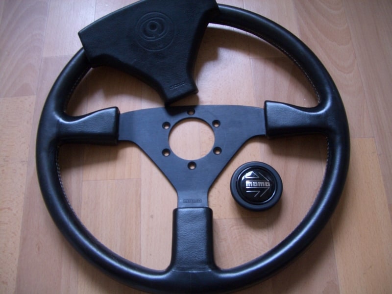

I'm currently getting the 89 NA6 that I've just purchased ready for registration. It's fitted with a black Momo steering wheel (very common one judging by the Google Images). I assume that this is an aftermarket wheel.
According to the registration rules:
"If the original steering wheel was designed with a recessed or padded hub, the replacement wheel should be of a similar design."
Is anyone able to advise if the original wheel had such? I haven't been able to find a 100% stock standard interior picture of an 89 NA6 to check.
EDIT: just found this:
Is that the same Momo wheel with a crash pad fitted?

twr7cx wrote:It's fitted with a black Momo steering wheel. I assume that this is an aftermarket wheel. Is anyone able to advise if the original wheel had such?
ADM NA6 was fitted with a black Momo leather steering wheel & centre pad as pictured by KevGoat.
twr7cx wrote:EDIT: just found this:
Yes

Postby twr7cx » Tue Dec 05, 2017 10:49 am
93_Clubman wrote:ADM NA6 was fitted with a black Momo leather steering wheel & centre pad as pictured by KevGoat.
Thanks. Looks like I need to source a centre pad then.

twr7cx wrote:Thanks. Looks like I need to source a centre pad then.
Red Dragon wrote:My wheel passed rwc twice without the rubber pad.
second time was to go on club plates
They are hard to come by but i saw one go for $90 a few months ago
Yeah, it tends to be the police that defect the absence of the centre pad, but not on all NA6s they encounter.
Centre pads are scarce here, but more common in UK so check UK ebay etc, however note that there are two types, one that has 'Mazda' in the centre (ADM & UKDM NA6s), & one that has 'Eunos' in the centre (JDM NA6s). USDM had a different wheel as an airbag was fitted.

93_Clubman wrote:however note that there are two types, one that has 'Mazda' in the centre (ADM & UKDM NA6s), & one that has 'Eunos' in the centre (JDM NA6s). USDM had a different wheel as an airbag was fitted.
A handy tip, thanks. Are they compatible with each other? i.e. will either of them fit? I suspect that my vehicle is a JDM imported Eunos.

twr7cx wrote:Are they compatible with each other? i.e. will either of them fit? I suspect that my vehicle is a JDM imported Eunos.
Yep, as hks_kansei has indicated.
Ref JDM Eunos Roadster or not, VIN will have NA6CE in it, but if ADM Mazda MX5, VIN will be start with JM0NA306... as per in following: viewtopic.php?f=18&t=34871&start=135
