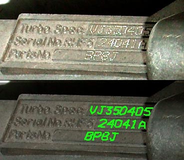

Postby Okibi » Mon Sep 10, 2007 8:25 am
Did you give them the numbers off the turbo in my pics?

Postby blackster » Mon Sep 10, 2007 10:41 pm
THE REAL BORIS wrote:
Okibi wrote:Did you give them the numbers off the turbo in my pics?
I would have (I even printed it for my file) but I would have been guessing on some of the numbers. Don't suppose you can verify them? :D
I'll have a crack:
Turbo Spec: VJ390405
Serial No RHF5: 24041A
Part No BP8J
Previous
04' MX5 SE.
02' MX5 Classic ed.
Postby Okibi » Wed Sep 12, 2007 1:45 am
This is my best guess:
Postby Okibi » Wed Sep 12, 2007 2:01 am
http://forum.miata.net/vb/showthread.php?t=232192
Off of the IHI turbo:
The turbo spec part # is VJ350407.
The Parts No. is #BP8J
http://www.miatapower.com/Body%20Parts.pdf
Part number from pdf BP8J-13-700C

Postby blackster » Wed Sep 12, 2007 11:14 pm
THE REAL BORIS wrote:Excellent. Stephanie is the odd one out with the last spec. digit of 7 though?
Asking for advice about the MSM from stephanie, now there's trouble..........
Email Keith from FM, im sure he will be more then happy to give you the information you need, highly likely they have a few units laying around after doing FMII upgrades.
