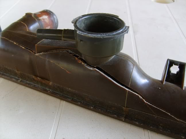

Anyone with one 10yrs older or more should consider this as preventative maintenance. I had mine replaced last week because it looked a bit suspicious. All discoloured and some crazing of the surface. I took the old one home for a closer inspection and squeezed it very lightly and this is what happened. :shock: Glad I had it done before hand.

FWIW I replaced mine a few years ago when it developed a small leak, they cleaned the core out too, but a few months later I replaced the whole core because it was overheating. (problem solved with a new radiator)
So consider going the whole hog rather than just doing the top tank...

OTOH, I had my top tank replaced (same cracking as OMY005) over 3 years ago and no probs with the radiator since. Previous owners had kept the coolant in good condition though so there was no \"mud\" in the system.
