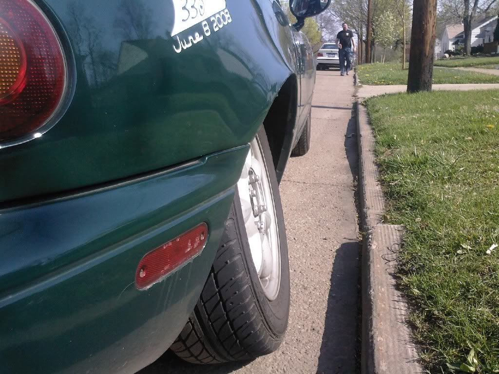

Recently installed coil overs into my 01 mx5.
I want to get rid of the rear camber but the only adjustable arms I can find are eBay ones.
Does any body run these?
Are there other options?

Cmon guys, everyone knows that when you lower the are of an NA or NB, you gain excessive camber for the street. I had trouble getting my turbo roadie to less than 4 degrees neg on each side at around 110mm pinch weld height.
Eccentrics slip. Few people recommend them.
The ebay/just jap arms have a tendency to break unless you modify them in a specific way. Avoid unless you do your research on how to make them work without snapping in half.
The easiest (and cheapest) way to fix the problem is to slot the mounting point for the knuckle/upright in the upper control arm. Extend it out 5-7mm and bring the top mounting of the rear upright out in the slot. Tighten up the upright at the outer point of the slotted hole and readjust the alignment. Problem solved.

I'm at 115mm and my alignment guy had no problems setting the camber at the 1.8deg I requested.
100% OEM adjustment, no slotting, cutting, arms or anything.

Buy a lottery ticket... Then post pics of an inclinometer on your rear wheels on a flat surface. Also interested to know what your tow figures were on the rear when you achieved these figures. In my experience this isn't possible unless you're running 13" wheels.
I'm still wondering why anyone would buy eccentrics or ebay arms. Slotting OE arms is so easy.
