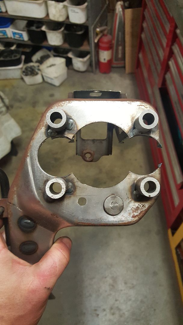

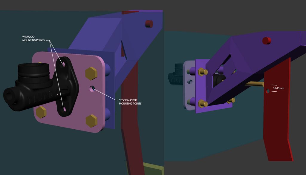

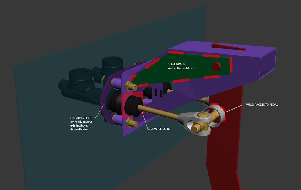

ok... So the brake booster and the pedal box is out.
The dual masters is probably going to be easier than I had expected as I think as the centers for the master cylinders happen to line up with the existing mounts on the pedal box. This means I can bolt straight through from the master through the firewall and then through into the pedal box without even requiring a spacer bracket. The only issue with this approach is that parts of the pedal box will need to be removed to clear the master cylinder pin. I could offset it out but I much prefer this approach as it will be easy to brace the pedal box where material is removed, and it means the masters are directly fixed to the pedal box which will give added rigidity.
With the balance bar, I'm going to weld it directly into the pedal so that the pivot points remain unchanged. Once again a direct attachment is better than mounting with bolts as I think any movement in the brake linkages would reduce pedal feel. I'll also have to make up some longer pushrods to drive the masters as the existing ones are too short.
Note: the pedal box isn't to scale... representative only!
I've purchased a 5/8" (0.625") master for the front and a 0.7" master for the rear. I specifically undersized them a little as I'm not going to change the pedal ratio with this approach and the smaller size will give me some additional leverage, with the side effect of additional pedal travel.
Right, now for anyone who wants to use their existing master then the pedal ratio is going to have to change. This means the master will have to move up a bit. I've designed a simple bracket that moves the master up 10mm, and allows for either the stock master or a dual Wilwood to be bolted through to the pedal box (picture shows a single master, but the mount points are the same). I'll get this bracket cut out of 8mm ally and mount it up and see how it works. A hole will need to be drilled in the pedal, but this could be positioned 10-15mm above the existing point so that the ratio can be increased more or less depending on your requirements.

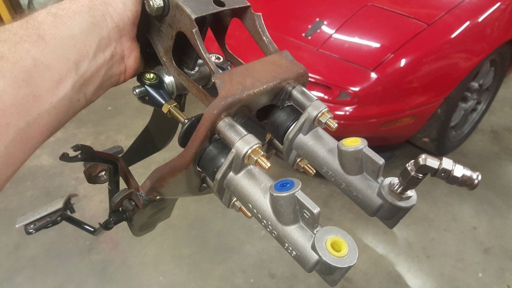

Spent a couple of hours in the workshop tonight and got the dual masters set up. I haven't changed the pedal ratio yet but it will be done by dropping the top pivot down 25mm and shortening the top of the pedal. I'm thinking of trying it as is to see how much the pivot changes the pressure.
The movement is great... nice and smooth and will be easy to adjust the bias. I'll probably add some bracing on the sides where it has been trimmed but the firewall will hold it all together well and the top bolts to the chassis so I doubt its going to move at all.
Nice... very easy and should make for excellent brakes.

Brake pedal box and masters are all in position... just need to connect it all up to the brake lines now.
Here is my custom brake distribution block that I drilled and tapped. It has ports for input from master and brake pressure sensors on top and then outputs on the bottom to connect to the brake lines.
My phone battery died after taking these shots so I'll upload some photos of it all installed later today.
