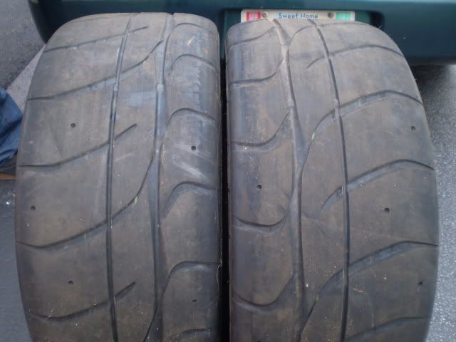

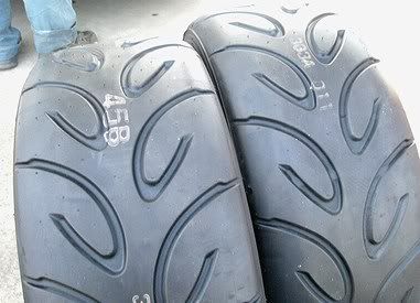

Pity you don't live somewhere sensible, Dave, like Moruya. I've got a set of R888s, a set of A050s, a set of StarSpecs and a set of KU31s here. You could try them all. :D R888 and NT01s are very similar tyres, both very R-spec, made by the same manufacturer.
R-specs look like this: huge block size, low void ratio, no fancy little patterns to make them quieter, very soft compound (you can drive a fingernail into them), bad when cold, need heat to get sticky, ratshit in the wet;
