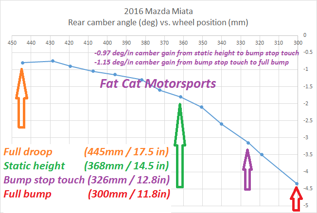

NitroDann wrote:Replacing coilovers in an mx5 doesnt change anything about the alignment.
It does if you change ride height. Camber varies with ride height/deflection.

That's what I thought. Changing springs/coilovers is unlikely to give you the exact same ride height as before, thus an alignment is required. I suspect a big change in ride height occurred here resulting in alignment being stuffed.
I suspect the coilover instructions would mention an alignment is recommeded after fitting.

A typical coilover install will lower the car increasing camber evenly side to side, which affects nothing from most peoples perspectives.

NitroDann wrote:A typical coilover install will lower the car increasing camber evenly side to side, which affects nothing from most peoples perspectives.
Unless you're as obsessive about suspension settings as I am. :wink:
For the other obsessives, here's an example for the ND:

1" drop, +0.5* camber, sounds awesome for like...... 99% of people who fit coilovers.
Im not saying youre wrong, you aren't, but I think that "always get an alignment after fitting coilovers to an MX5, because it's good practice" is like "Only buy a car with a full dealer service history, because it's good practice".
It's only good practice if you don't really know what you're looking at/doing.
