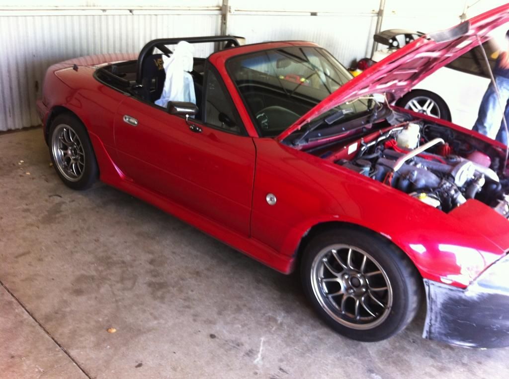

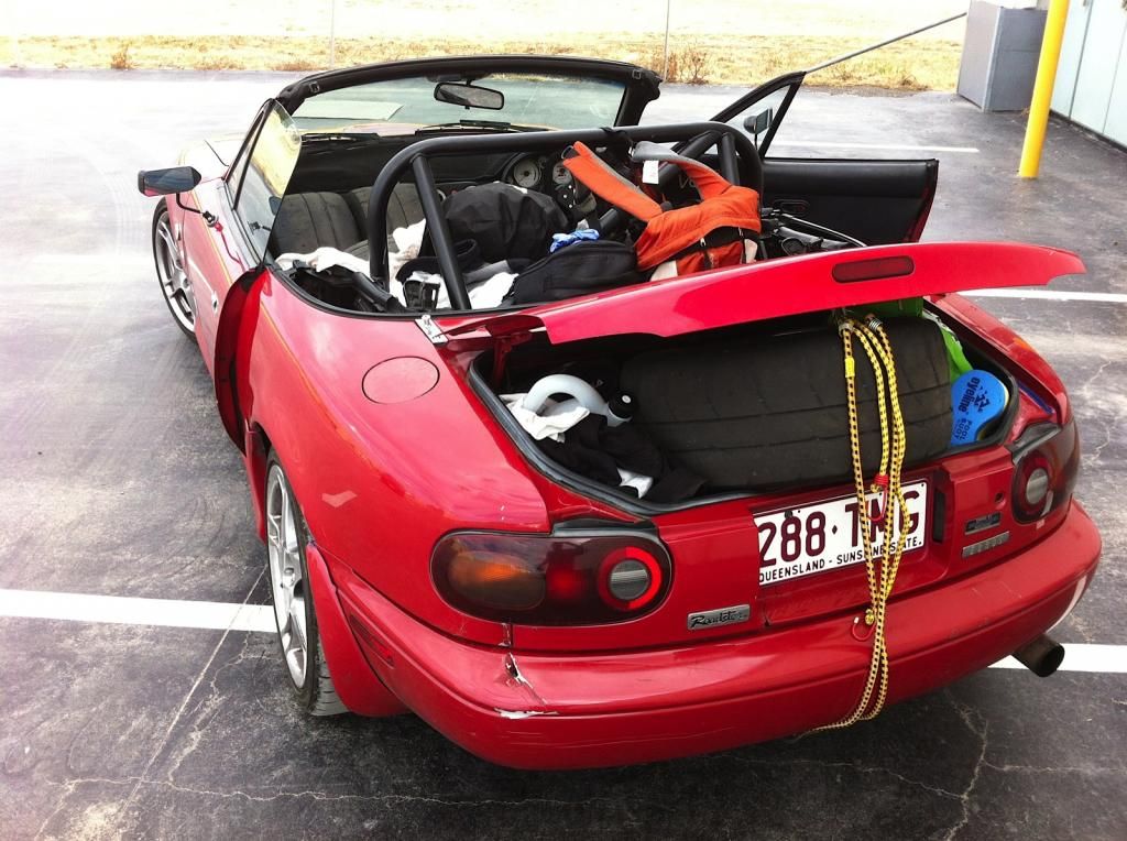

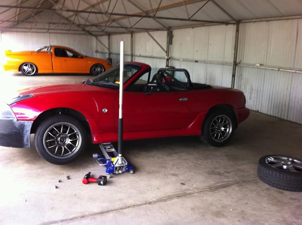

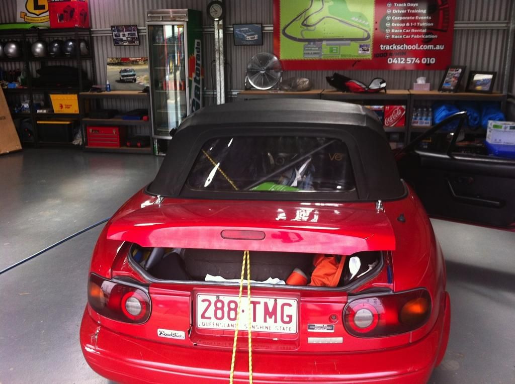

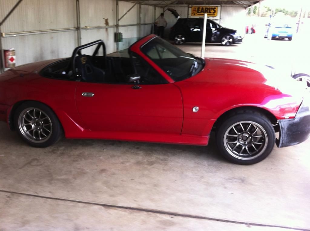

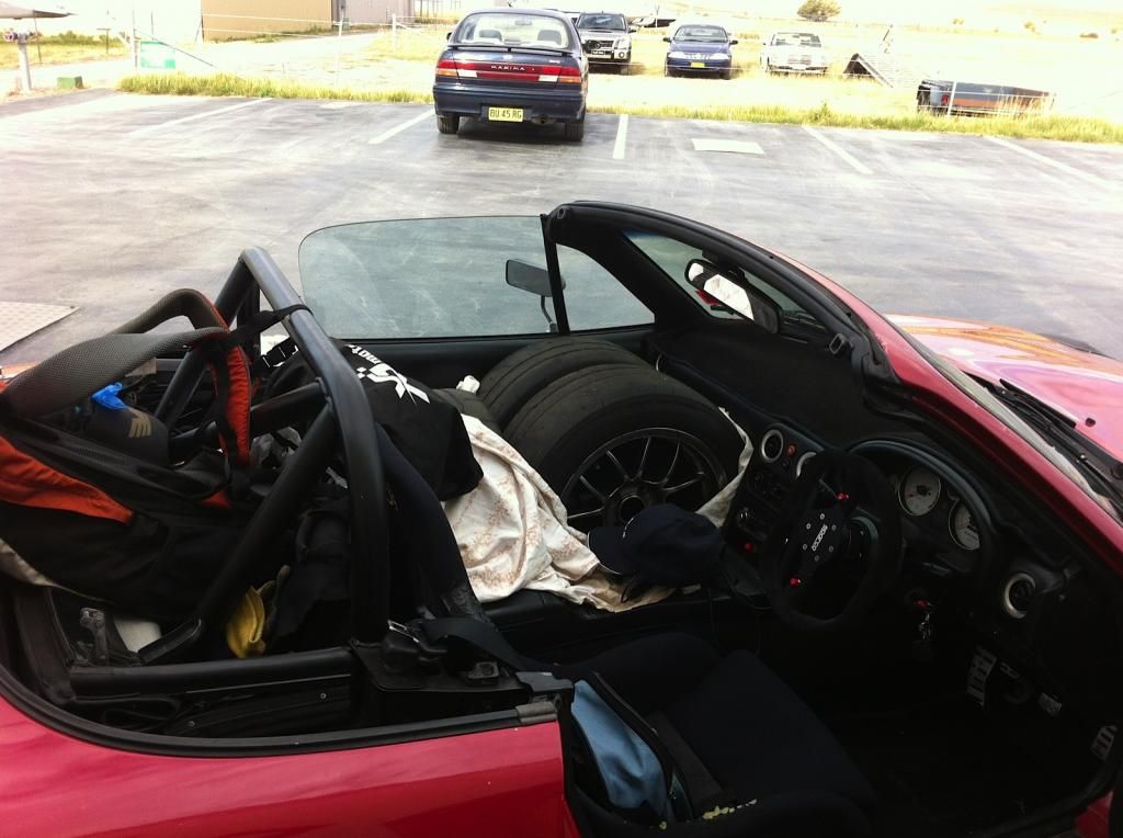

davekmoore wrote:Thanks for the great pics. Is there anything a little more, erm, stealthy at all?
Hey Dave-Probly this post is about D to D but I need a Guinea pig to test the newfound talent of pic posting from benevolence of 'Slug Dub:)
so the reality to test the many theories=
Not sure if the photo sequence is A about F but the correct sequence is from the one with the softop up which is on arrival at Wakefield Park after drive from Melbourne (not your 'normal' drive to the track commute, but to prove a point, "overkill is appropriate"!:)
so you see three 'track whls/tyres in the pax posit + inverted seat & other hidden necessities, and 4th track wheel in the boot. Not as traditional with the magic bungee cord fastener but not illegal, and plenty fresh air dilutes the attendant CO fumes. The reason no closey is these are 9" 6ULs with 225 45 15 tyres so it CAN be done & no attention from the vigilantes.
Then you see them unloaded/trackies on/go have heart failure for cpl hours or so/reload for the next trip( to Newcastle)/ & Bob's you uncle!:)
(BTW you may recognise the road wheels as they used to be under your 'Barmy' once up.....
