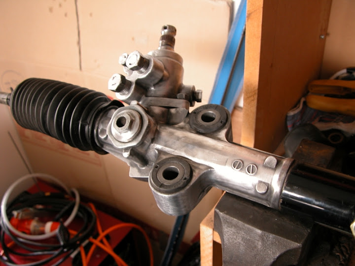

Here's a pic of the rack
See the large hexagonal pancake nut there? Loosen that, tighten the smaller nut visible in front of the pancake nut very slightly (like 1/10 of a turn) and then tighten the pancake nut again. I think it's a 38mm nut from memory so you may have difficulty finding a spanner to suit.
This can all be done while the car is on the ground if you can get in there, from memory the nut points to the front of the car, and is on the driver's side of the rack...

bilbobaggins wrote:thanks for the replies guys. Caffeine, you seem to know what your talking about. Ill get under the car this weekend and see if tightening the nut helps.
Good luck, it helped my car but may not be the cause. One of the cheapest thing to check though :)

bilbobaggins wrote:finally got around to tightening that nut.Trying to get my hands on something as big as 38mm was quite hard haha. The first time i did it i did it too tight and the wasnt getting any feedback on the road. I then loosened the nut abit and now feels good. No more Loose feeling :D . There's still this other problem i'm getting. When driving on straights or slight bends just by steering a few degrees on the steering wheel can sometimes cause the car to turn abit excessively, but thats only sometimes.
Good to hear it helped.
The other problem may be alignment, toe out on the front can make it a bit sensitive
