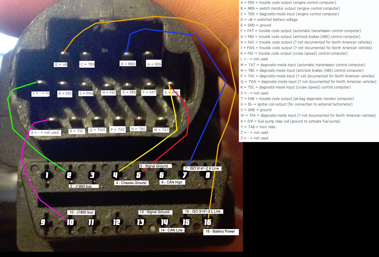

I've been looking into retrofitting an OBD2 port to an NB8A to allow use of a ScanGauge type tool. From the pictures of OBD2 ports on the American forum, it looks like it is using the ISO 9141 protocol with a single data line on pin 7.
Looking at the US wiring diagrams, it looks like this data line comes from pin 1D on the ECU as well as coming out in the diagnostics connector on the top row of pins, second from the left. All the other pins required for an OBD2 connection appear to be present in the US diagnostics connector too (pin 4 ground, pin 5 sensor ground, pin 16 battery positive).

There's a pin present in the right location of the diagnostic connector on my car:

Thanks 93_Clubman but unfortunately you can't really see what 1D is doing from that picture.
