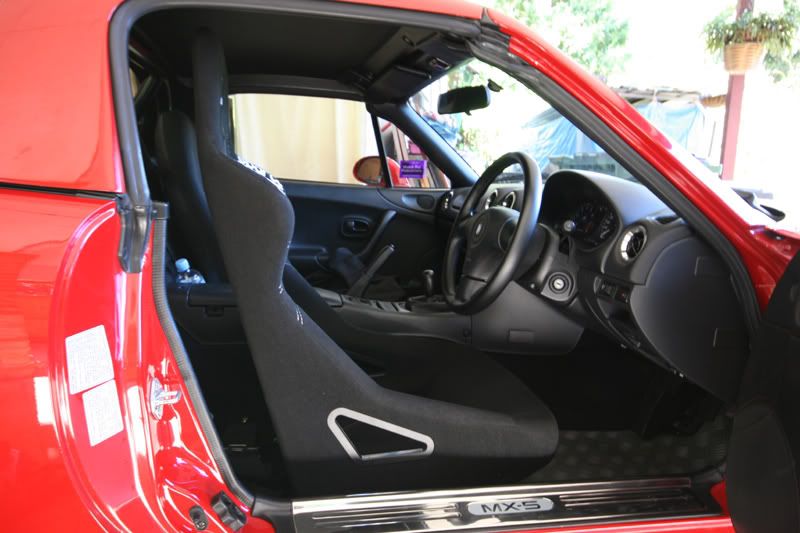

Ok well the seat is in and today I took some photo's
I'll take some of the rails when I take out the seat later on and get some pics comparing hight as well later on, but for now here are some fitment pictures.
As some may know I used the Stock rails so I can still slide it forwards and backwards as seen here

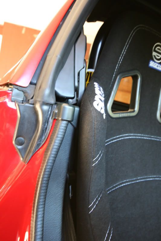

Fitment is great, only slightly touching the hardtop latches when all the way back

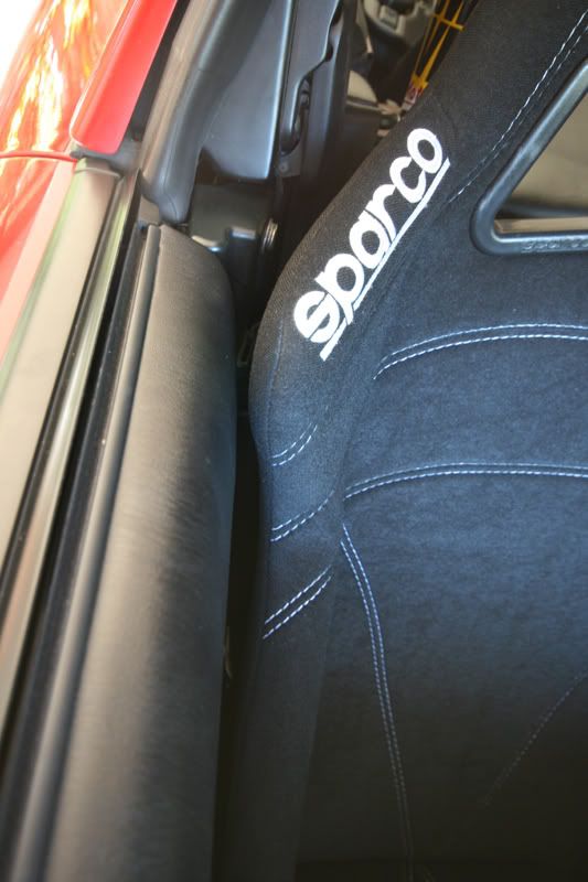

doesn't touch doors

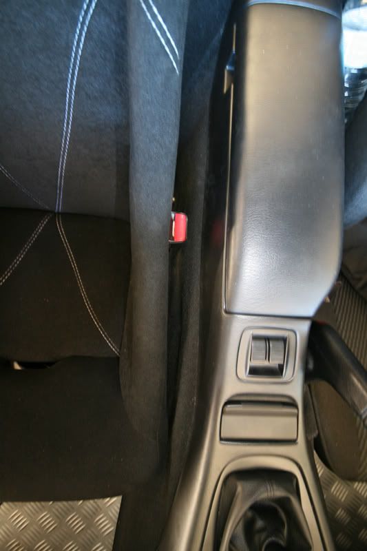

If placed all the way forwards it will touch the transmission tunnel but otherwise it has more clearance than the stock seat (this is with seat halfway)

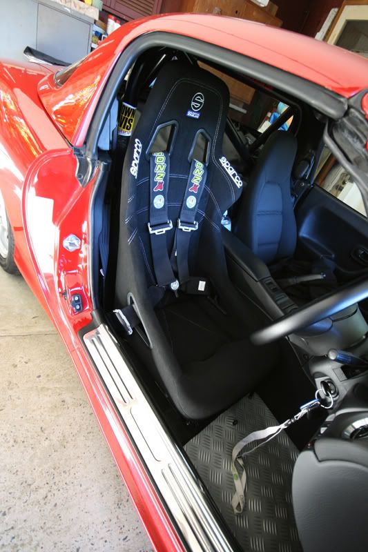

but harnesses are better 8) (lower straps going in next week)

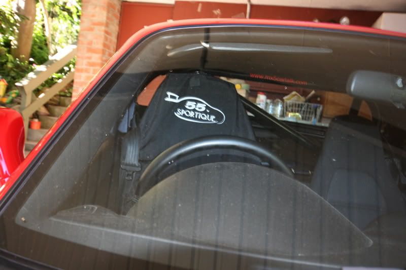

I was worried about getting too much attention to the car with these seats but they look soo good
so I have them covered up (when on the street without harnesses)
