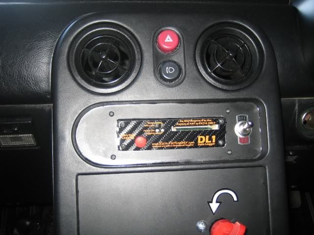

looks good mate
could run the power from a switch next dl1 save having the light plug

Looks like a nicely packaged product! Why not stick the magnetic antenna base onto the top of the windscreen surround? You could also tuck the cable away neatly within the rubber seal.

Yep, eventually I'll hard wire it into the car and put a seperate power switch next to the logger, just need to get a switch and fuse. This just gets me up and running for Lakeside next weekend.
I had considered just putting the antenna on the top of the windscreen surround, but I wanted to give it the best possible chance of picking up every available satellite. The antenna actually gets very little positional or speed information from satellites directly above, it gets far more info from satellites on, or near the horizon.

Found a couple of hours last night to fit a dedicated switch for the data logger.

that looks better mate :-)
