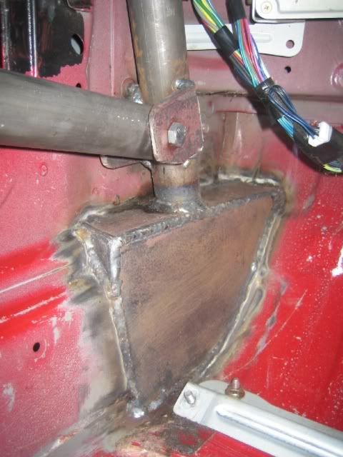

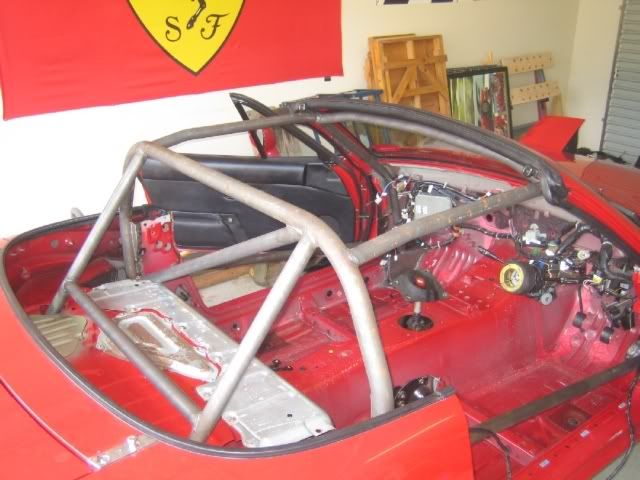

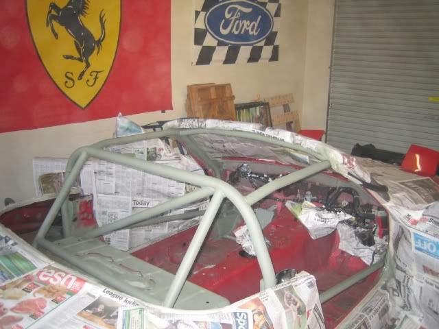

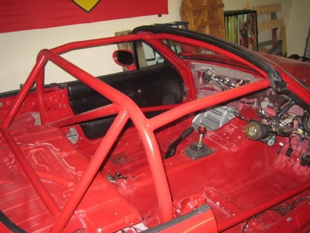

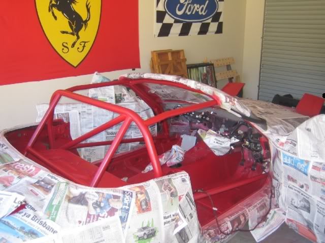

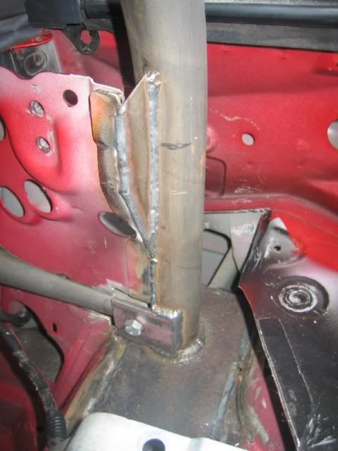

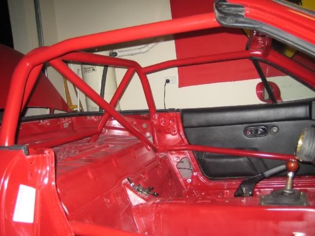

I got the car back from the cage builder on Friday so it was another busy weekend.
Here's a few shots of the cage:
Bottom of the main hoop:
Footwell and bolt in side intrusion bar:
Then a few coats of primer:
A few coats of colour:
And a couple of coats of clear:
And it's all ready to be reassembled:
Paul.
FMS01
Posts: 151
Joined: Sun Mar 05, 2006 5:48 pm
Postby FMS01 » Mon Mar 31, 2008 12:37 pm
No tabs on the harness bar for the eyebolts?
Julian

Postby SKYHI » Wed Apr 02, 2008 10:09 am
FMS01 wrote:No tabs on the harness bar for the eyebolts?
Julian
Harnesses are wrapped around the harness bar.

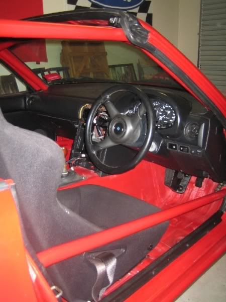

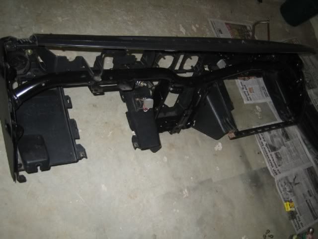

Another couple of busy nights.

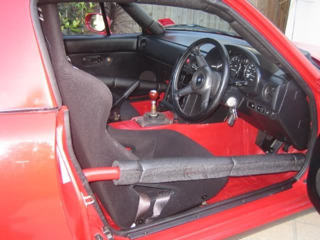

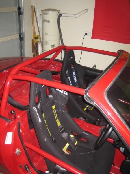

Bar behind ths dash all painted and replaced:
Dash, instrument cluster, steering column surround, wheel and wiring all done:

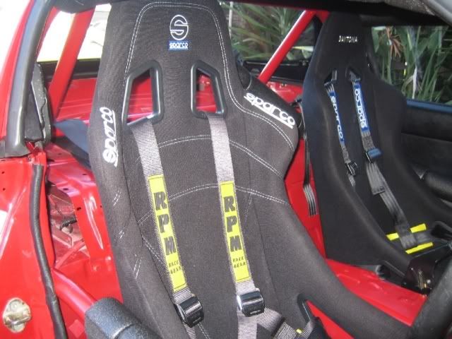

Seats on original rails and 2" 4 point harnesses (I have a 3" 6 point harness for the track):
Pretty much done for the mod plate except for some roll cage padding.
Paul.

Well here she is ready for the mod plate:
Paul.
