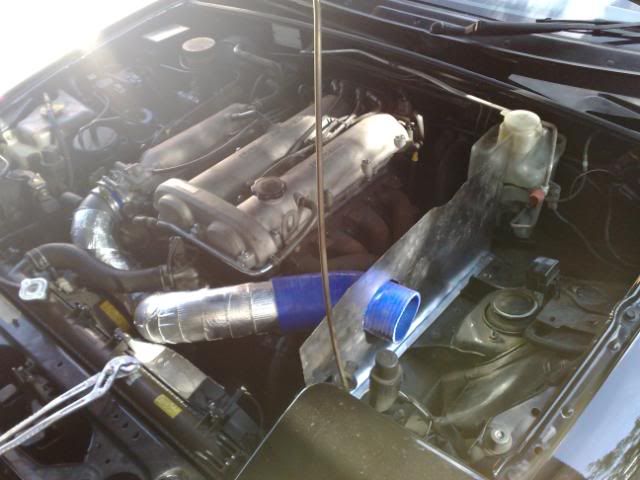

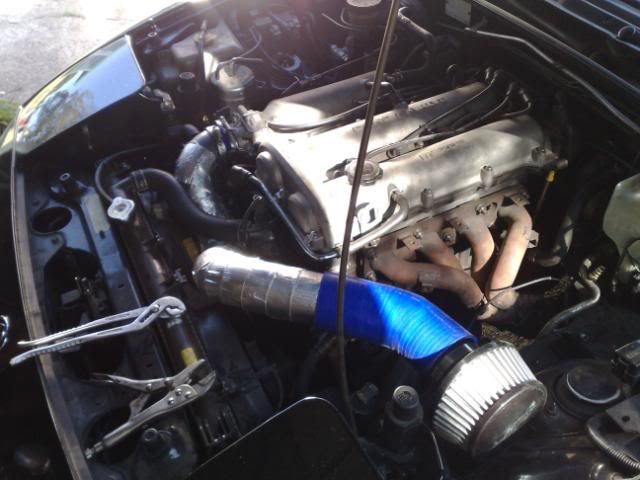

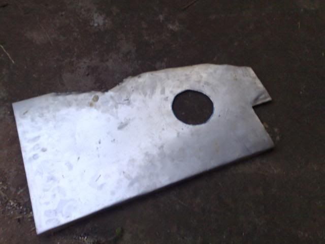

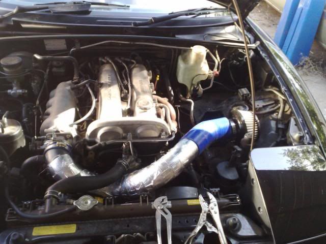

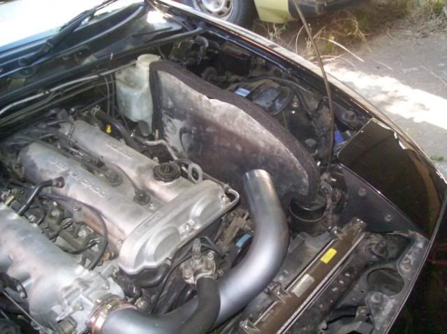

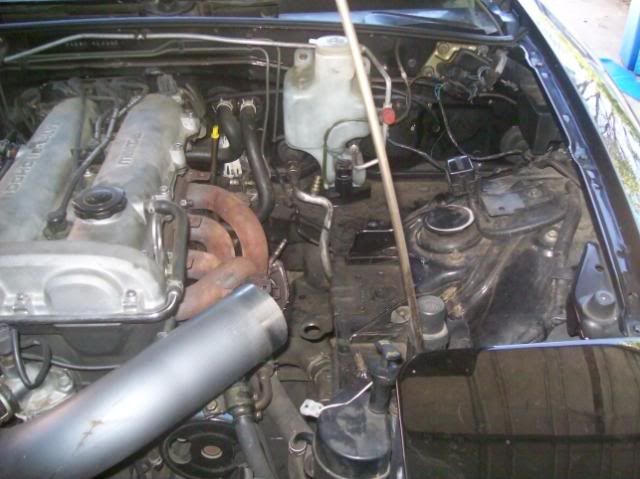

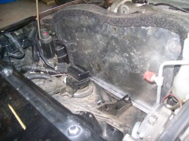

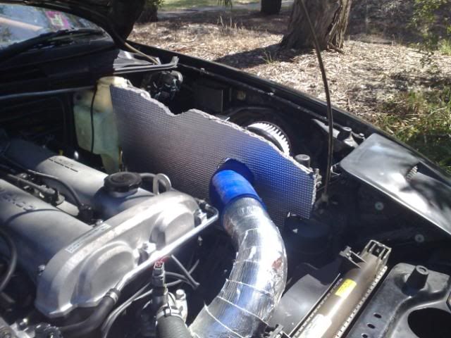

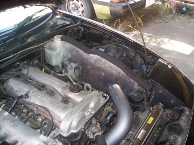

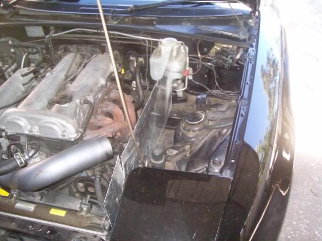

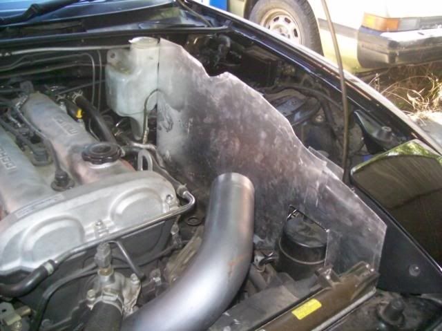

I'm not sure if this will stick or not, but here's the build process anyway. Check out this thread if you're interested, I start in on page 7.

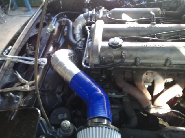

Bare intake pipe with no filter.

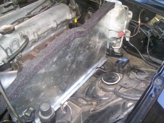

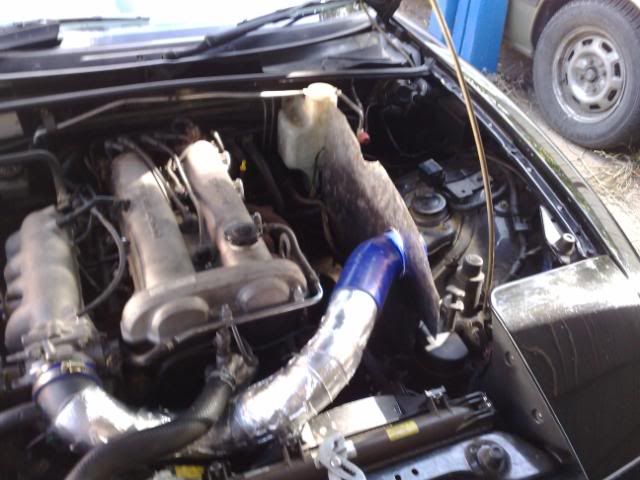

Theory is to seal off the passenger side of the engine bay from the left edge of that shelf.

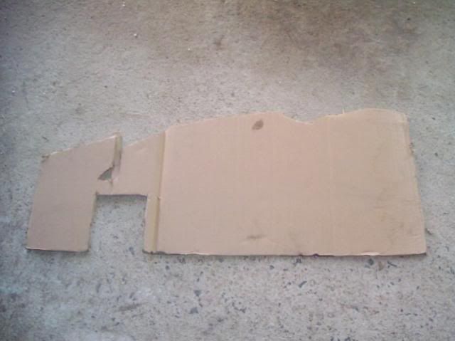

Cardboard = win

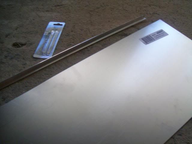

The parts I needed to buy; 2mm sheet aluminium and jig saw blades.
Template traced on

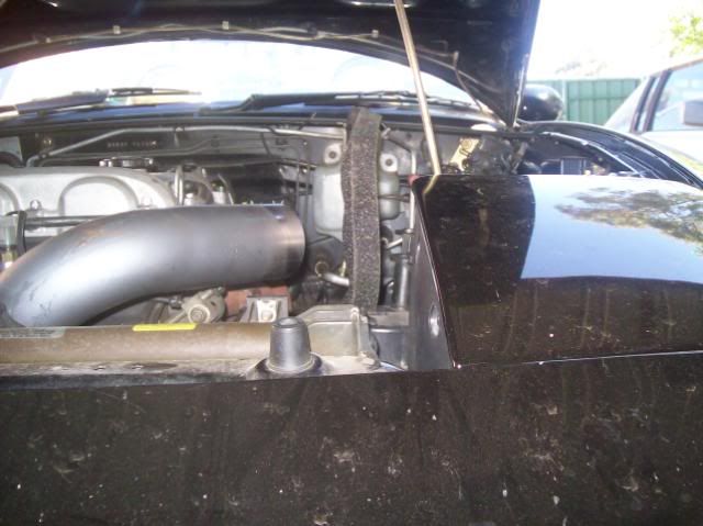

Test fitting
Test fitting the foam.
Test fitting the filter and silicone joiner
The hole for the joiner to go through

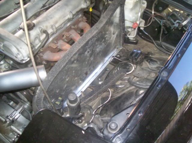

Test fitting the joiner and the shield together
All together, complete with 5mm heat shielding foam on both sides of the aluminium

Nice CAI design
Only thing I find is the air has no where to escape so the bonnet often gets a wobble from all the air not being able to escape...
Steampunk wrote: Oh you've got Ohlins? You must like drugs too!!!
Joe's NA6
Postby Hammer » Wed Feb 04, 2009 12:40 am
jcs86 wrote:Nice CAI design
I agree. You'll need pressure differential to have air enter the vent. Otherwise you'll simply have pressure lock.
There's a couple of thread with good link to articles that talks about such topics.
Posts: 3658
Joe's NA6
Postby Jeo » Wed Feb 04, 2009 12:03 pm
Hammer wrote:I agree. You'll need pressure differential to have air enter the vent. Otherwise you'll simply have pressure lock.
I can see where you guys are coming from, but doesn't air leave the airbox to go into the engine?

Postby corners » Wed Feb 04, 2009 12:21 pm
The engine doesnt use the same amount that is flowing into the air box as such especially at higher speeds so therefore the air gets trapped and has no where to escape.

jcs86 wrote:The engine doesnt use the same amount that is flowing into the air box as such especially at higher speeds so therefore the air gets trapped and has no where to escape.
But by that logic, wouldn't that happen to any airbox with a large air feed?
And by air getting trapped, filling up the airbox and presumably increasing pressure; would that then create positive pressure at the filter head?
