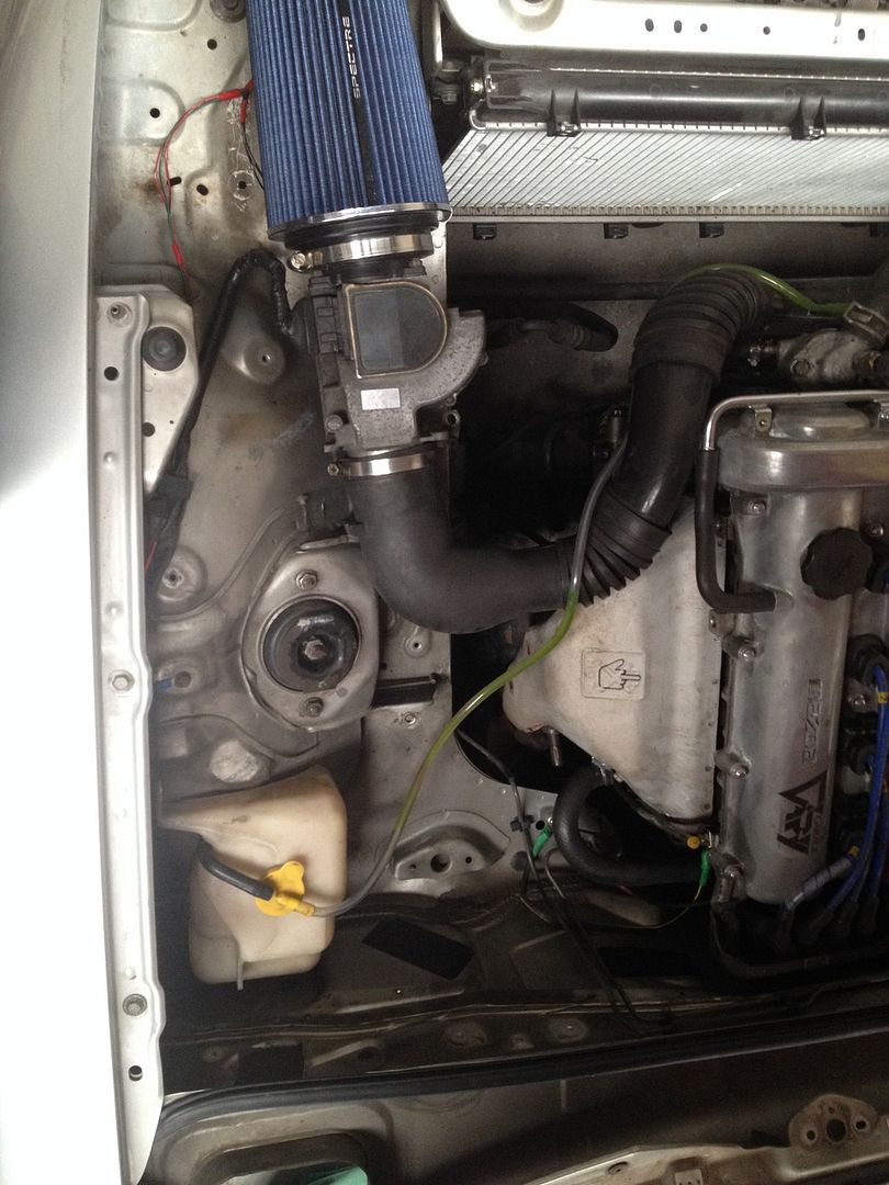

Coolant overflow relocation.
Wonder why there aren't any pics of the front?

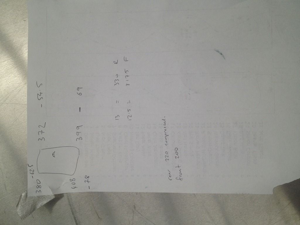

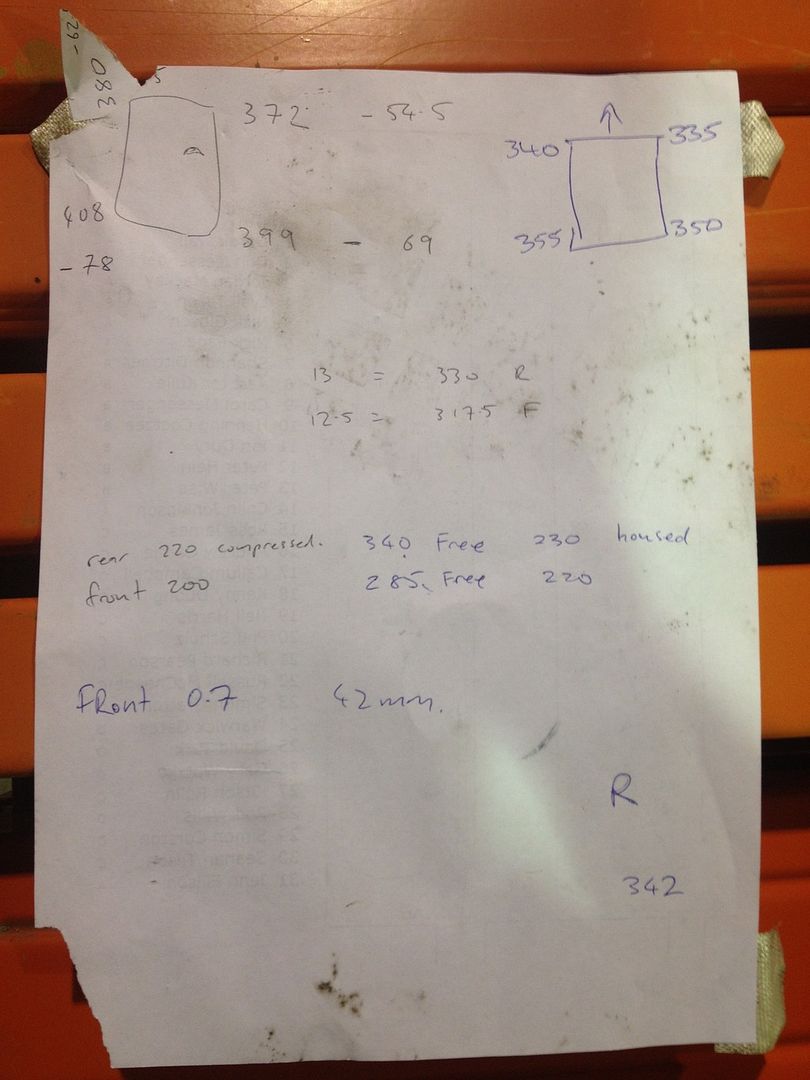

Some doodling to guage how much to cut the springs by (measurements are hub to fender).

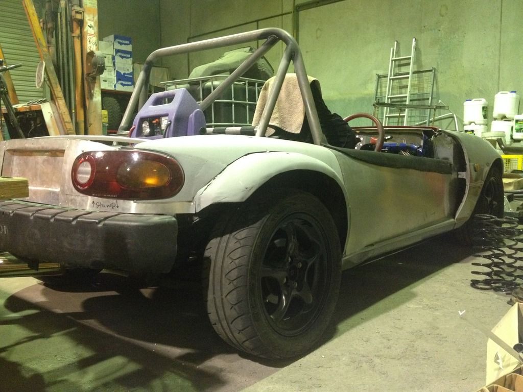

Chopped the springs tonight, I cut them on an angle so the load is spread out as much as possible on the top hats. (The American the new shocks might look familiar)
I had to divide the loaded spring lengths by the free spring lengths to get the ratio to increase the amount of cut, then throw that out the window because they wouldn't stay captive.
I wanted 12.5/13" but ended up with 13.4/14" - still miles better than it was.
Now I can get a wheel alignment.
