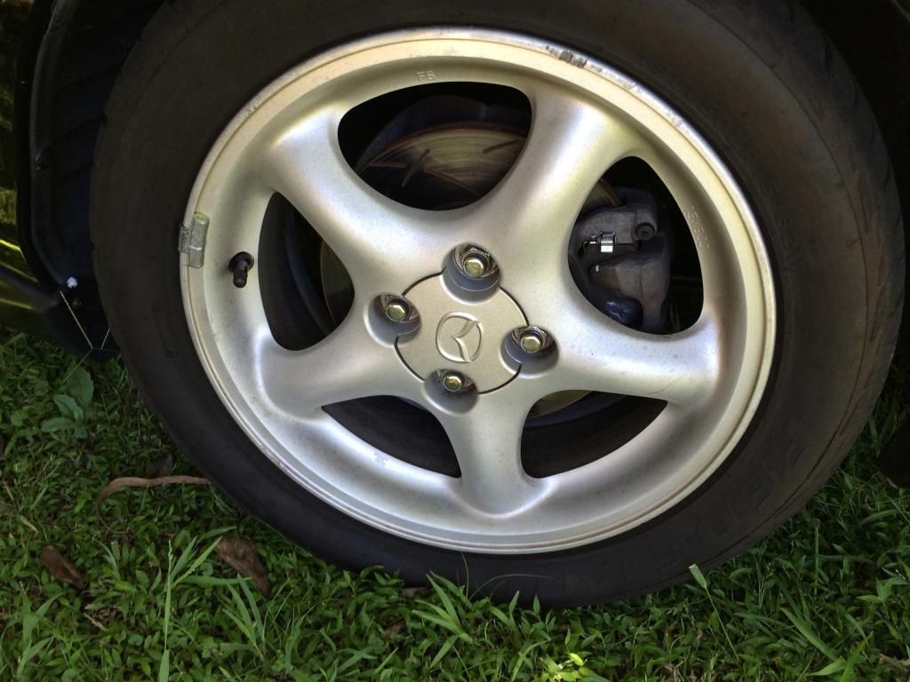

Re: Snowmotion's NB8a
Picked up some Bowden's Wheely Cleaner at the Supercheap 20% discount Saturday.
It seems to do a really good job on the wheels. Cleaned inside and out.
- Posts: 10910
Yeah, it's cool the way it changes colour (reminds me of a more expensive brand) but I wasn't blown away by the performance, been impressed with other Bowden's stuff.

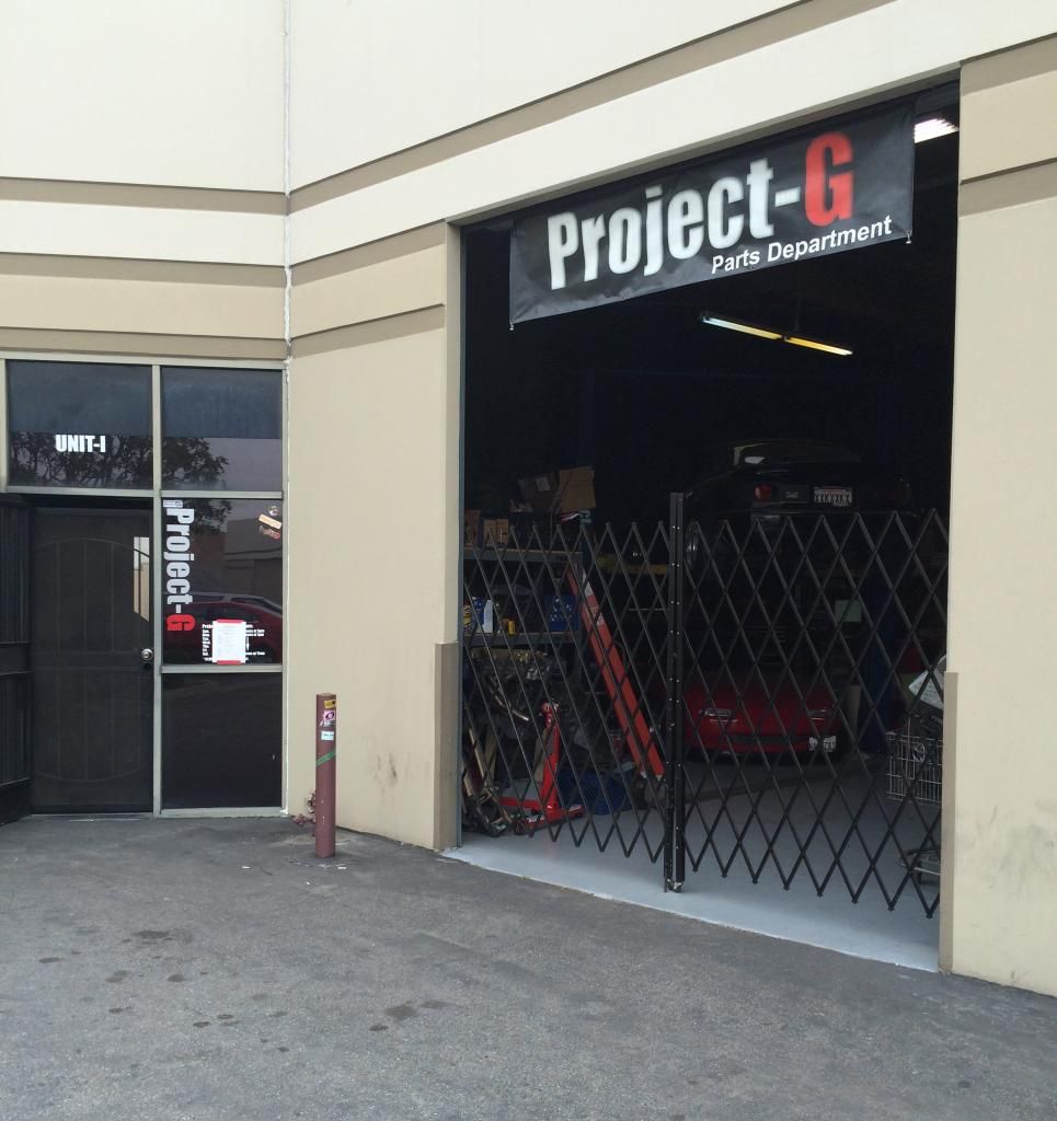

Just had a 12 day trip to the USA and managed to schedule a day in LA so paid a visit to Project G.
It was great to see their set up and talk to them.

- orx626
- Posts: 1774
- Vehicle: NC - Rotary
Snowmotion wrote:Just had a 12 day trip to the USA and managed to schedule a day in LA so paid a visit to Project G.
Picked up a set of vented Qtr windows.
Cool. Did you pop down to the other end of the building and visit Roman and Dave at Blackbox Motorsports?
- Posts: 750
- Joined: Mon Jul 29, 2013 8:47 pm
Damn... I did not know about them!
It was a Saturday and not many of the units were open.
Project G are open on the weekends as they have an indoor 1/10 Electric Drift track.
