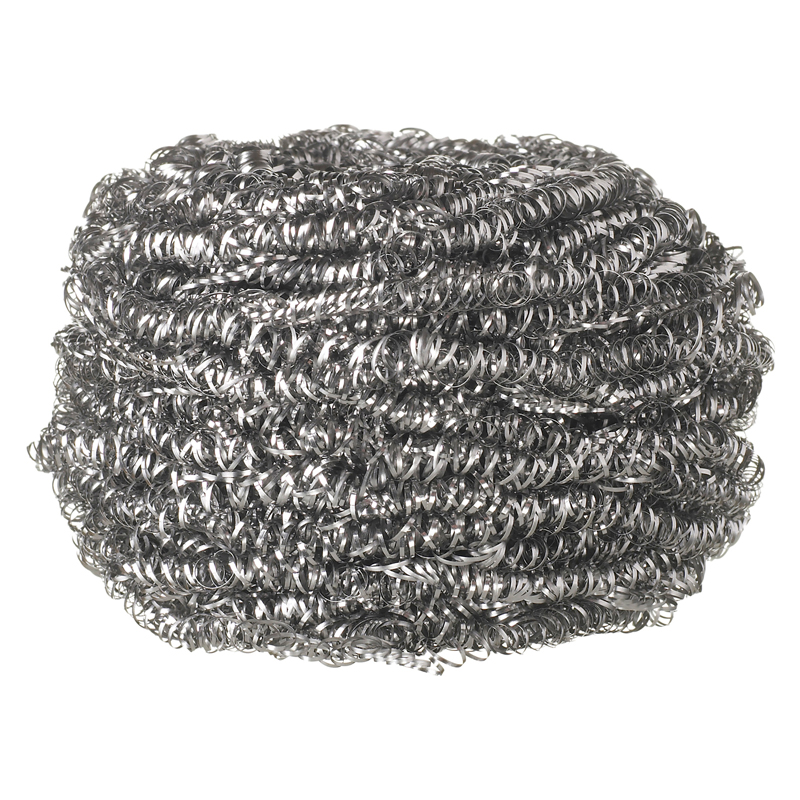

In terms of baffling, I am hoping to keep it fairly simple and allow the air to slow turn back on itself a few times. The inlets will be located just above the little leg with the hole for the powersteering reservoir bolt. Any thoughts on the baffling?
Just fill the can with some of this, loosely packed...
