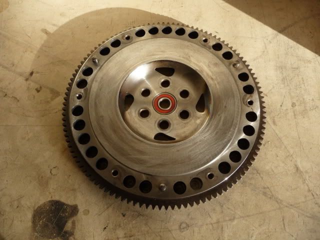

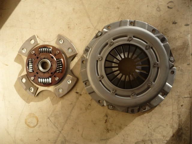

Now have a new clutch and lightened flywheel ready to go in.
The flywheel is actually a second hand one I bought from one of the other MX5 racers here in Brissy. It's a chromoly flywheel with the original 1600 ring gear attached to conform with the CAMS 2F regs. Weights in at 5.2 kg.
New Exedy clutch and pressure plate, 4 puck with a clamping pressure of 2400lb, and both weigh 4.8kg. Made by NPC at Archerfield.
