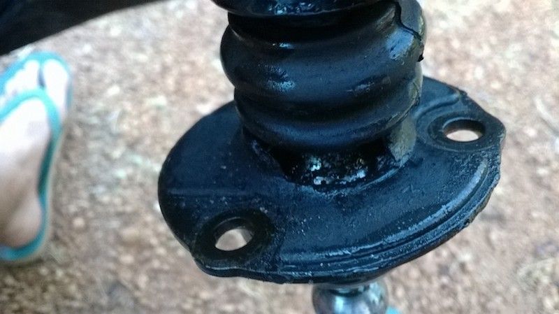

So the day after the first track outing for the car and I notice that it isn't the same to drive as it used to be. The gear selection was sticky and the clutch felt different. The worst of it was the gear selector was sticking to one side when in the neutral gate. By this I mean if it was pushed to the left while in neutral it would stick there, the same if it went right. After work I took the shifter boot off to inspect the gear turret and it had NO OIL IN IT! In a way I and happy because I thought I had found the problem and part of my was pissed off that there wasn't any oil in there! After a heap of looking around and asking questions I found out that the SE turret isn't supposed to have oil it D-OH!
The boots, both upper and lower are torn which I guess doesn't help the matter.

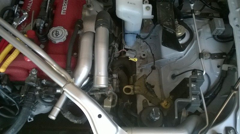

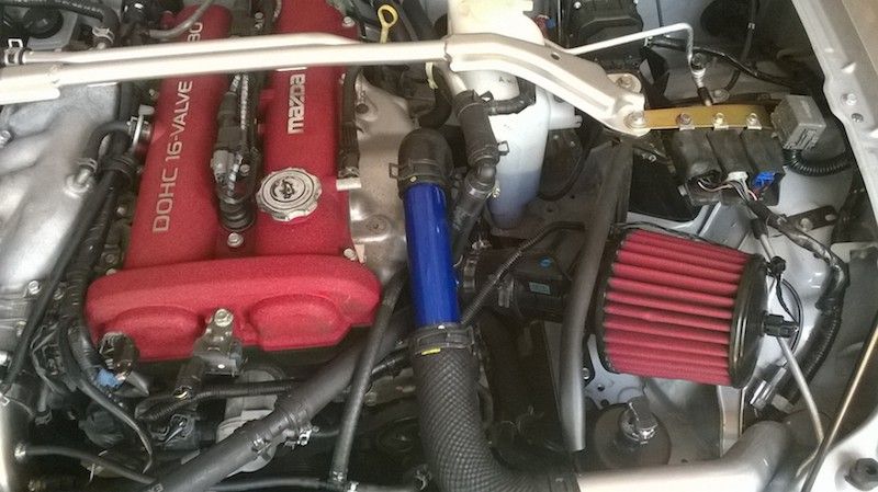

So I am back in town and chomping at the bit to do some modding to my car. My AEM intake arrived while I was away. A small lob like that was just about perfect considering how knackered i was from the previous 15 consecutive 13 hours shifts out in the desert. So I hopped straight into it. Now I won't bore you all with the little details, especially because just about everyone else in the WORLD with an SE has done this mod. So I thought I would mention the things that i did that made the job easier.
The first was unbolting the strut brace to allow easy access to the bolts underneath.

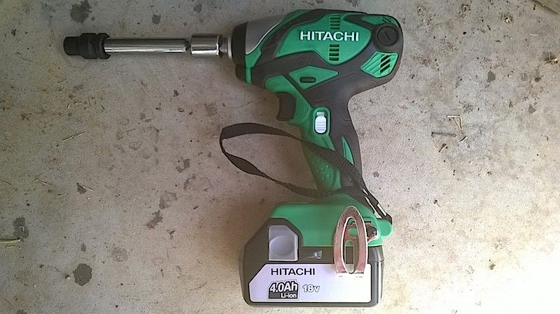

Confession time.... I bought this to take out to work with me but love it too much to waste on work!! For anyone looking for a supra high quality and heavy duty impact wrench, this has GOTTA be the one.

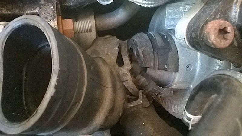

This is where the rubber elbow from the OEM intake joins the turbo. As others have said it was melted on making cutting it off with a stanley knife necessary. Basically what I did was cut the elbow off just past where it is connected with the turbo. From there I made a lengthways slice along the elbow rubber and used a blade tip screwdriver to prise the rest off the metal. It was a little bit tricky but simple enough in the end.
To be able to position the heat shroud in place (I tried for about 20 minutes before I modified it with no success) I had to cut an extra section out of it to accommodate a hose that was right in the way. It was a simple case of cutting away at the shroud with an angle grinder and finishing it with a flap disk. After the mod the bolt that fastens both the shroud and the power steering reservoir went in very easily.
The end result. It isn't pretty, I have pretty much just left everything where it lay. I will tidy it up after I am sure that it is all working as it should.
I ran the car up to check for issues and it all looked ok. The engine note already seems better so I am happy

How many hours do you estimate it took to fit it. I am expecting delivery of my BEGI CAI tomorrow.
Steven
Steven
- Posts: 110
- Joined: Wed Sep 25, 2013 11:08 pm
- Location: Perth Hills
Re: Putting some hair on the chest of a nice lady's car
WASP wrote:How many hours do you estimate it took to fit it. I am expecting delivery of my BEGI CAI tomorrow.
Steven
Hey Steven, It took right on two hours including the mods. It might/will take a little longer if you are trying to be neat with everything.

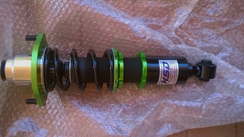

Just curious.....
Why did you go for HSD over the alternatives in the same price range, ie. BC Racing & Yellowspeed?
Did you get the factory offered spring rates of 8/6 or go for something different?
Nevyn72 wrote:Just curious.....
To be honest there wasn't any one thing that made me go for the HSDs. It was a combo of recommendation, reviews, availability and wanting something a bit different I guess. I went 8/6
- Posts: 169
- Joined: Tue Mar 27, 2012 11:45 pm
- Location: Perth
You'll definitely be happy with them
I installed them myself but got the alignment and height adjusted at Wheels World in Osborne Park (recommended from the forum) If you feel like taking the drive they'll look after you.
