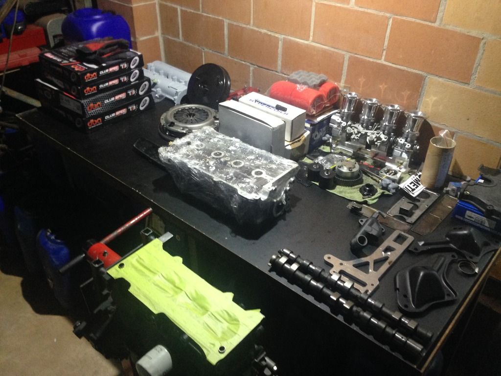

So i got the head and everything mounted together, havent been properly assembled as head still need machining and cams

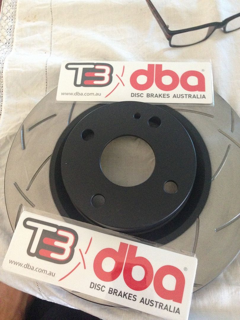

also ordered some rotors which arrived today, rears however are going to be sent later as they didnt have any, paid 50$ each brand new so im happy ;)

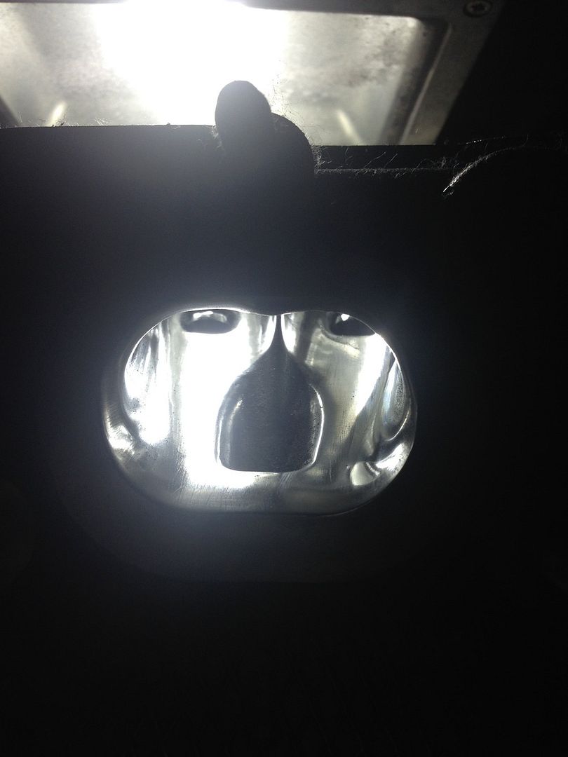

so, still waiting on customs to hurry up and give me my stuff, but, in the mean while ive gotten bored and decided to clean up the ports on the head aswell as polish them, machine work will be done in the next few weeks aswell so head should be going on soon.
everyone says different things about polishing the ports but seeing as i dont see why there would be any issue in doing so i have done just that,
if someone gives me good enough reason as to why its no good, i can always hit it with some 400 grit or the sandblaster ;)

actually going to hit the intake ports with the sandblaster to roughen them up a bit, main reason for the polishing was to see how close the intake profiles were to eachother and they were almost spot on so time to get em back a bit rough

I need new brakes, mind sharing where you got the rotors? Sounds like a great price.

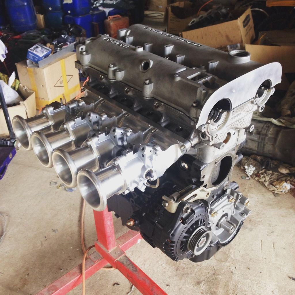

The picture of the ITB's all mounted up makes me all tingly inside.

sadly, the place has stopped listing the ones i ordered, i ordered the T2 rotors, and they sent me the T3 rotor for who knows what reason
the T2 were 50$ a corner and the T3 are 180$ a corner, maybe they re listed the T2 but they are called spares box (online site only and australian aswell, pretty sure they are melbourne way!)

Zabinskii wrote:actually going to hit the intake ports with the sandblaster to roughen them up a bit, main reason for the polishing was to see how close the intake profiles were to eachother and they were almost spot on so time to get em back a bit rough
Sweet. The reason that the ports aren't meant to be polished on the intake side is that turbulence in small doses is good, it creates a better environment for fuel to disperse in the air prior to the chamber, creating a better burn. Also less likely to have lean spots etc.

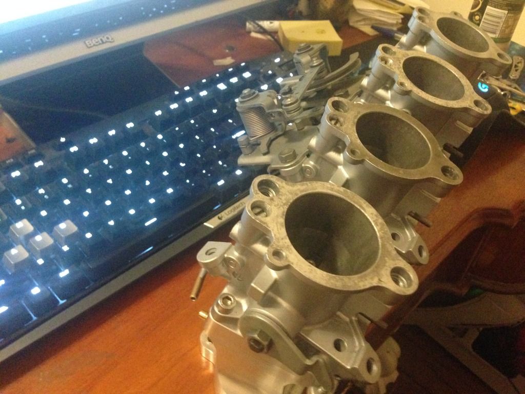

quick update, ITBs are back together after a quick clean up. just to get them all re surfaced and then synchronized
working well, had a few issues with reassembly however it was just the butterfly shafts were a bit off center causing the butterflies to rub against the intake bore. now to get the adapter plate anodized and in time assemble the head.
