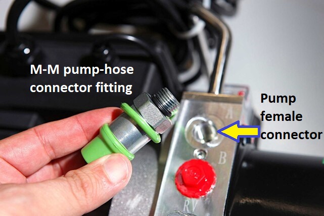

After a few phone calls and e-mails containing photos to clarify exactly what QuickJACK fittings I'd received and what I SHOULD have received, my 2 new quick connect male-male fittings between the pump and hose arrived the next day - damn good service.
Fittings kit as it SHOULD have been:
I'd receieved 4x F-M fittings rather than 2x F-M fittings and 2x M-M fittings.
Male hose to male pump quick connector:

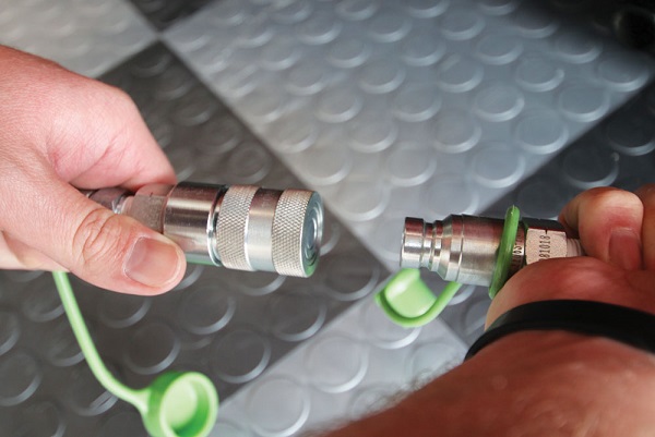

The quick connect fittings require quite a lot of force to connect once full of hydraulic fluid so if you're planning on a LOT of wrenching by hand, or it's just a quick job, you might want to leave them connected while working on the car.
At any rate, connect them first to the pump to relieve some pressure, then to the jacks.

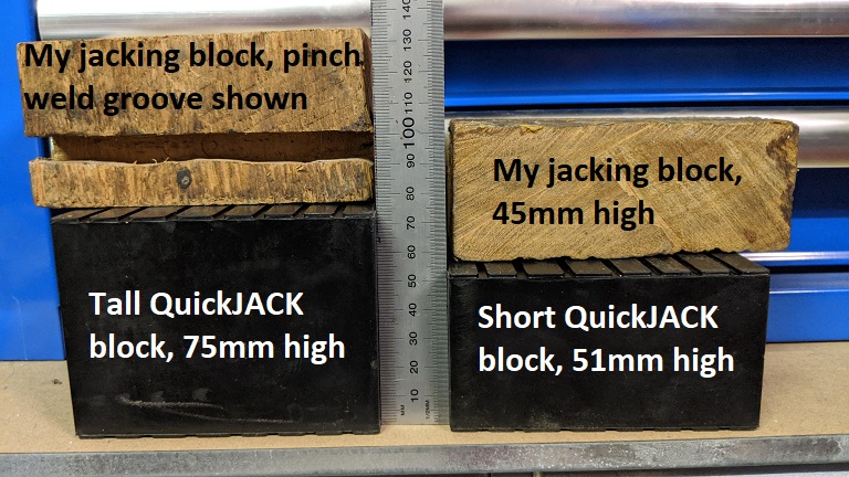

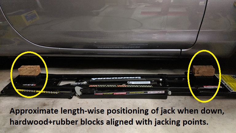

The QuickJACK comes with 2 sets of rubber blocks, 4x tall ones and 4x short ones.
I've ordered a set of pinch weld blocks too since I prefer to use blocks that accomodate them and don't damage the pinch welds.
With the jacks under the car, I can fit the shorter rubber blocks and slide my DIY hardwood blocks on top along the pinch weld which makes the alignment with the jacking points very easy:

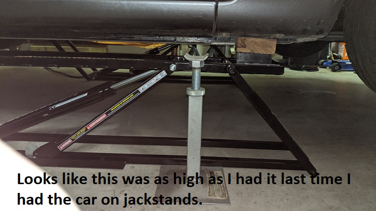

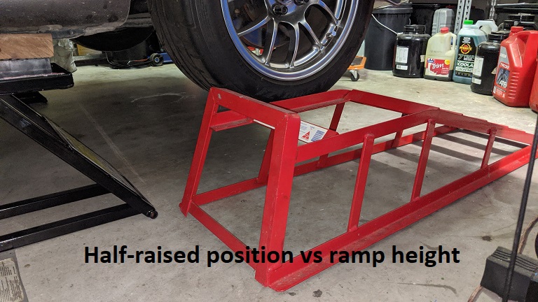

Jacks raised to half-way locking point (380mm ground to pinch weld):
This height is useful to get under the car and still work in the engine bay - it was also about the height I was using last time I worked on the car (I always put a hardwood block on top of the stand).

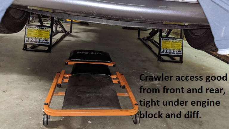

Jacks raised to full locking point (475mm ground to pinch weld):
This height is great, I can actually roll over while under the car but it's too high to work in the engine bay for a "short-arse" like me.
I can go from front to back of the car on my crawler but it's too tight to be practical directly under the engine bay or gearbox with all the MSM bracing installed - skinny guys would probably be OK though.

Depending on which end of the car I'm working under, I'll probably still place my ramps under the wheels at that end - should never be too confident when working under a car on your own.

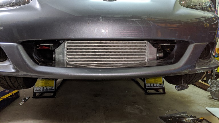

Years ago when I first bought my MSM, I replaced the token OEM intercooler with a real one from eBay.
I was concerned with how much the eBay intercooler blocked airflow to the A/C heat exchanger and radiator so I bought the Begi Air Scoop and installed it:
The scoop hangs dangerously low for DD and many people pointed out that while it would help with cooling the A/C heat exchanger and radiator with the extra air, it would also make the intercooler less efficient because there was now additional positive pressure behind the intercooler because of the extra air.
- so out it came!
Years later I installed a 300HP Fab9 Intercooler, TSE radiator, radiator top-sealing panel and SPAL fan and started to think about ducting.
I also bought two of MT.net's matrussell122 Radiator Support Bar (see https://www.miataturbo.net/miata-parts-sale-trade-5/radiator-support-bars-more-airflow-cooling-99508/) in preparation for it (the bar was cheap and I figured I could split the cost of S&H with someone because there was little difference between 1 or 2 since they fit in the same box).

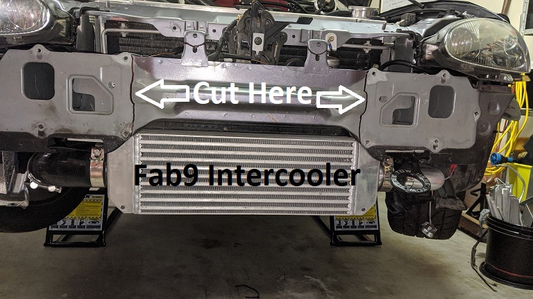

Here's the front view of my MSM with the Fab9 intercooler installed.
Note how the intercooler dominates the intake and there are large gaps on the left and right hand side.

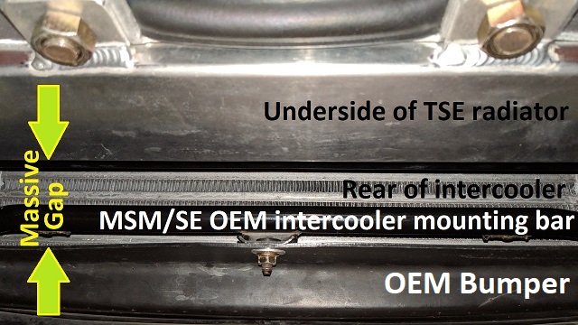

From underneath the car, you can see massive gaps between the intercooler and TSE radiator and between the OEM intercooler mounting bar and the bumper:
I began thinking about those gaps and thought "Why not create a chamber between the intercooler and A/C heat exchanger and exit the intercooler air under the radiator?".
The advantages of doing this are:
1. There is no pressure behind the intercooler so air can pass easier through the intercooler, making it more efficient
2. Only fresh air will flow into the chamber between the intercooler and A/C heat exchanger (this is air that flows over the intercooler) so will not be pre-heated by the intercooler
3. Air passing through the radiator will only need to pass through the A/C heat exchanger
The OEM front engine bay brace had to go which was accounted for with my Ryobi grinder (with cutting wheel) and Ryobi reciprocating saw (only the 2nd time I've actually used it):

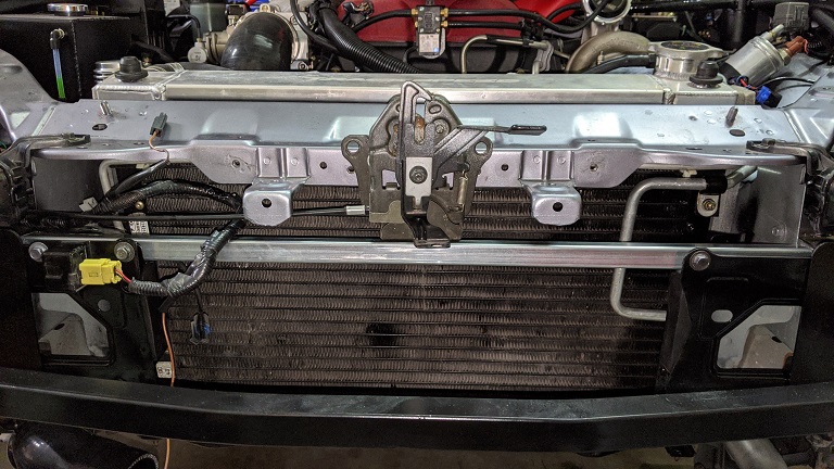

View from above:
The remnants of the OEM front plates were painted black to match the bar and coat the newly cut edges.
I don't weld so I thought "Why not bolt a stainless steel square bar across the top for added stiffening and to mount stuff from?":
Unfortunately the hood latch hangs too low - in this photo, the bar I was going to add is actualy positioned behind the hood latch.
So that's not an option and the amount of additional rigidity it supplied was questionable anyway.

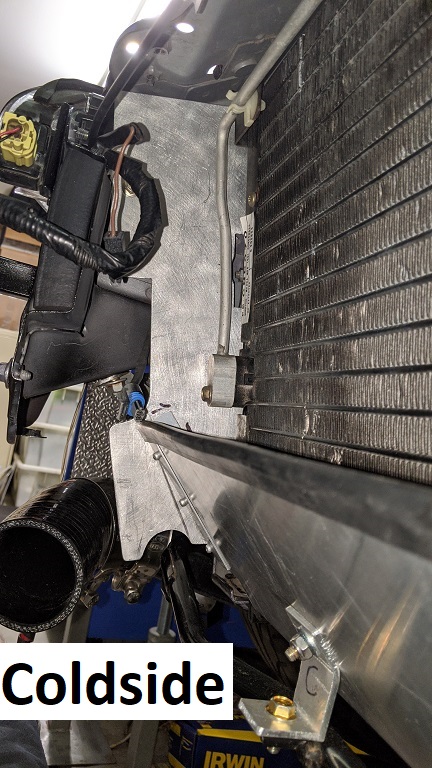

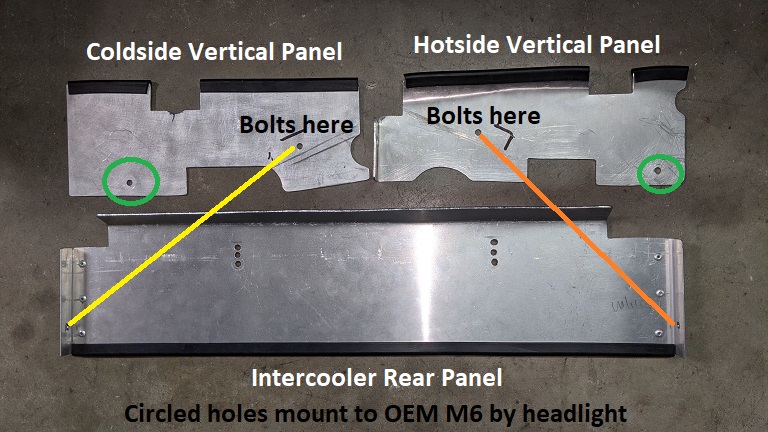

I started with the two side panels and dividing panel whose top edge leans against the intercooler and the bottom is mounted to the MSM's OEM intercooler mounting bar:
FYI: The large cutout at the front edge of the coldside panel is needed to accommodate the IAT sensor mounted in the intercooler tank.
Getting to this point took FOREVER, it took ages to get all the cutouts and angles right.
The panels are 2.5mm aluminium and the aluminium brackets on the bottom are made from pre-formed 3mm aluminium L-bar.

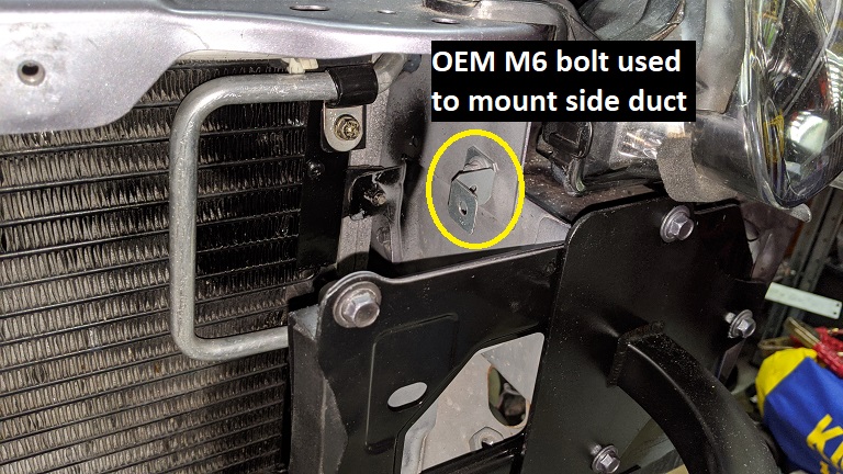

The top side panels were attached to an OEM M6 bolt near the headlight using galvanised brackets (I was over making custom aluminium brackets by now, these are easy to cut+bend to size and the bend is not as brittle as an aluminium 90* bend):

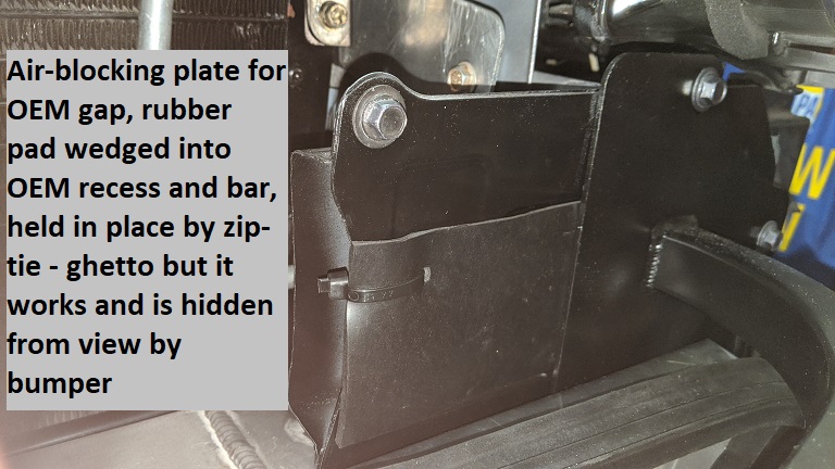

I added a couple of "Elephant Ears" to block off the gaps on the left and right side of the intercooler:
These panels are only 1mm thick and I used the same pre-formed 3mm aluminium L-bar to make brackets for the lower outer mounts so that they don't flex much.
To block the OEM front plate gaps, I went for a simple ghetto mod:
- so out it came!
I want to retain the OEM hood latch because a few years ago at Lakeside I noticed Bitrusty's SP only had Aerocatch hood pins and the leading edge of his bonnet could be seen rippling as it approached.
While I was doing this, I cleaned up some rust on my A/C heat exchanger and sprayed it with rustproofing black paint (I didn't mask everything off as well as I should've so there's lots of overspray).
Here's how it looks with the front bumper fitted (not as bad as I feared so I doubt I'll paint or add black vinyl cladding to the panels):
There's a gap below the intercooler and bumper which I'll need to fill with foam but apart from that, all incoming air should be funelled through the intercooler or A/C heat exchanger+radiator.
Mounting my number plate is the next challenge - it'll probably require DIY brackets to the new radiator bar (I plan on clamping it to the bar rather than drilling into the bar).
If anyone has any ideas, please let me know.
I also thought about welding some mount points to the top of the intercooler but it's a long way from the car's bumper so the bracket would bounce a lot.
It's a pity we can't have stick-on front number plates
