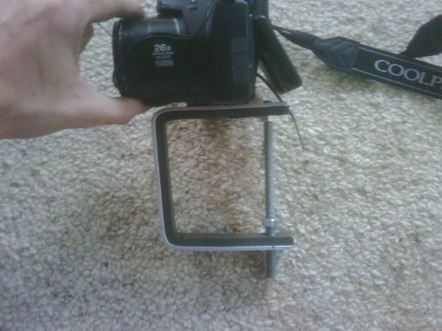

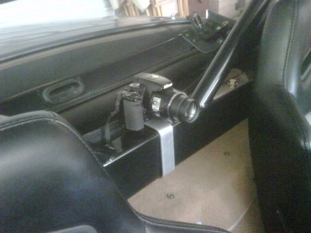

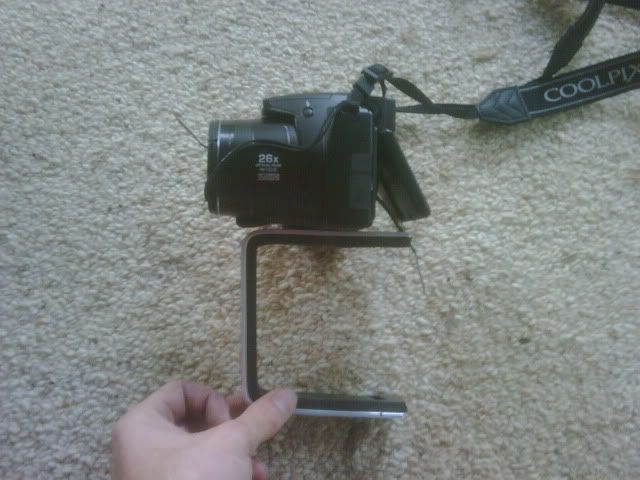

Made myself a camera mount and changed the oil today. Oil was as fun as ever but I'm pretty sure I'm getting better at the contortionist act required. Camera mount has been something I've been contemplating for a while and finally got around to doing it.
I basically diy'd a C-clamp. 25mm aluminium strip + a length of 8mm threaded rod + 4 nuts + self adhesive foam + an M6 bolt to mount the camera itself. Was as uncomplicated as it looks; all I did was bend the aluminium strip to make a C, cut it to length, drill some holes, cut the rod to length and I was done. To mount it was simply a case of bolting the camera to the C, slotting it over the bar, inserting the threaded rob and tightening the nuts. Pics should explain all really.
After it was all in place I drilled a few more holes in the top of the C to run cable ties through. The camera certainly didn't want to move of it's own accord but I figured it couldn't hurt to have a fail safe.
