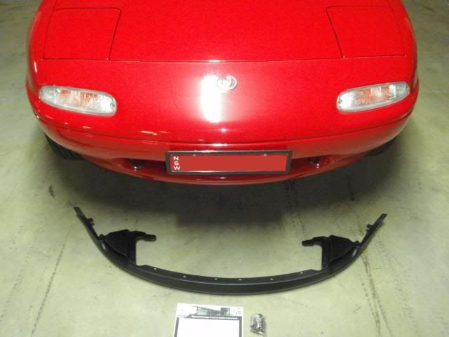

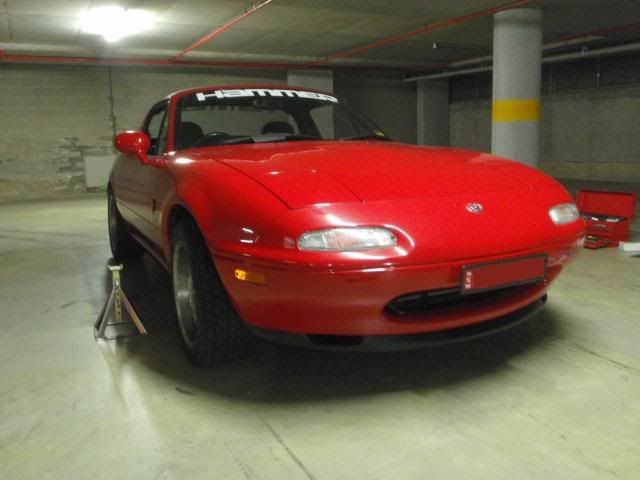

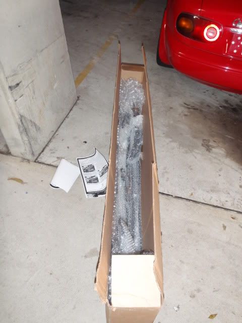

Well, after weeks of having my RSpeed (OEM) front and rear lip sitting in my garage, I've finally found time to install them on my Clubman. :lol:
They arrived nicely boxed. They were well wrapped and came with photocopy installation instructions.

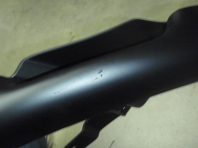

I'm pretty happy with the quality, though as you can see from the pix below, there are some blemishes on the lip (it looks like something that happened during the moulding process rather than post moulding damage). Since it's not that noticeable, it didn't worry me too much, but still a little dissapointed. :frown:
Before front lip installation

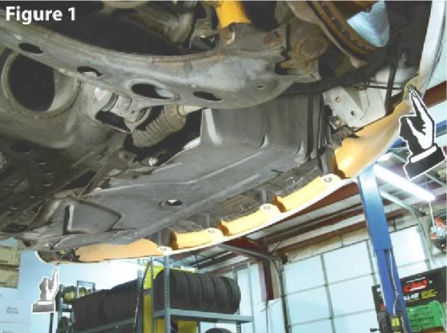

First step is the usual loosening and removing of bolts and screws
*Images from RSpeed

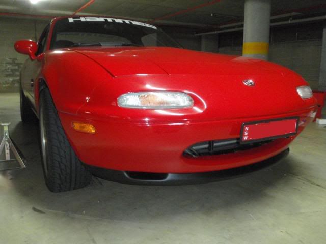

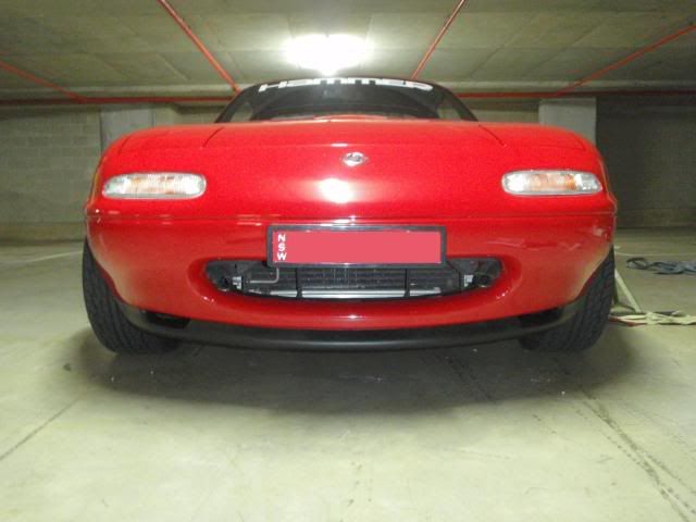

While the lip is very OEM like, it wasn't a straight fit. Being plastic, it could be as a result of some flexing of either lip or my bumper or a combination of both. There was a fair bit of flexing and stretching involved ensuring it lined up properly. The instructions also suggest clipping the lip onto the bumper with the supplied clips.
But in mine, if I did that, the ends won't line up. And if I line up the ends, the centre of the lip will pull away from the clip. Aaarrrg!!! :x

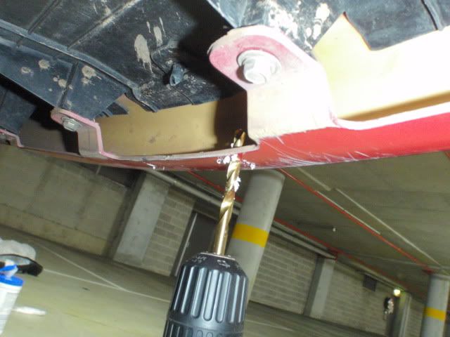

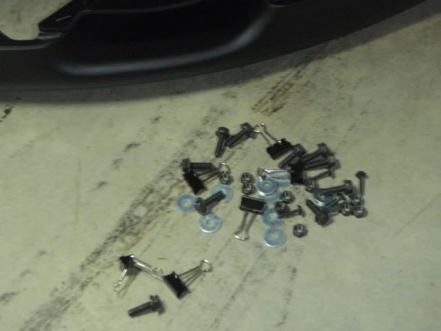

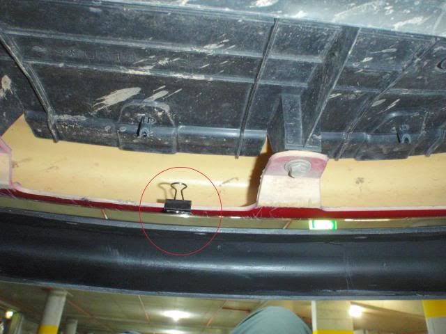

In the end, I abandoned using the clips as they were totally useless. Instead I screwed in both ends to secure the lip onto the bumper bar while I mark the drill points. My left hand stretching the bumper bar to line it up with the lip which required a bit of force to pull them in together. And with my right hand, marking the holes with a texter.
After a short prayer to the automotive DIY gods, I started drilling. I had a big sigh of relief when I finished without a mistake. Phew. :o
After a few small heaving and hoeing, I managed to fit and tighten all the nuts and bolt. Final step is to screw the end bits of the brake duct onto the under body engine cowling. The front lip took me over 2 hrs to complete

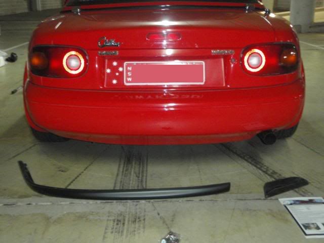

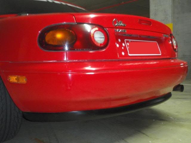

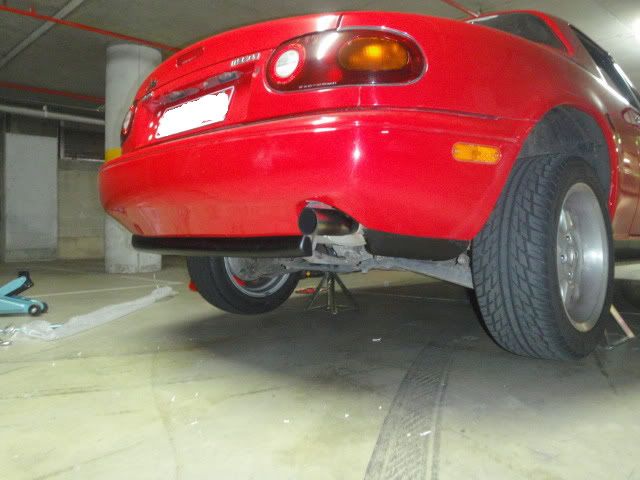

By comparison to the front lip, the rear lip installation was a breeze.
Before the lip installation. As you can see, the lip came in two pieces.

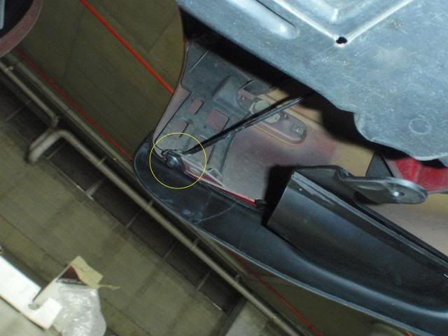

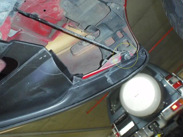

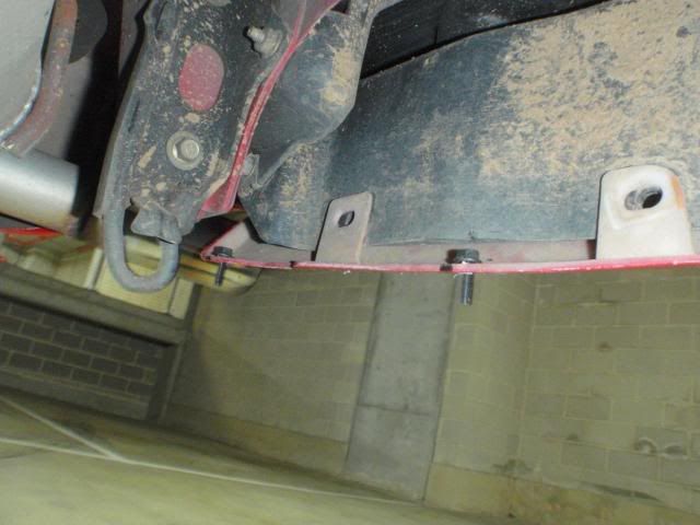

Once all the pre-requisite bolts and screws had been removed...
Images from RSpeed

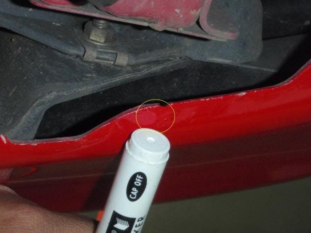

...I aligned the rear lip onto the bumper bar to mark the drilling points. I was pleasantly surprised when I noticed the rear bumper had very faint (but visible) markers that perfectly aligned to the holes where the lip was to be fitted. The markers comprised of 5 dots arragned like the 5 face of a dice. :o
This saved me the tedious task of marking the bumper and re-checking alignment multiple times to ensure it lined up property. Sweeeet. 8)

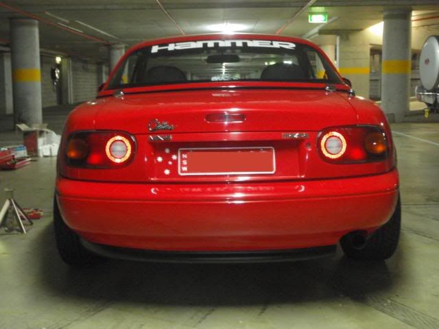

Here are the new bolts fitted ready for the rear lip.
In the end, the rear lip took me less than an hour to fit.
The only thing with the rear lip is the rear mudflap will not fit back on. I was told by several people that it can fit with some minor modification (mudflaps or lip spoiler?). I’ll need to do more research on this, as I would like to fit back my mudflaps.
