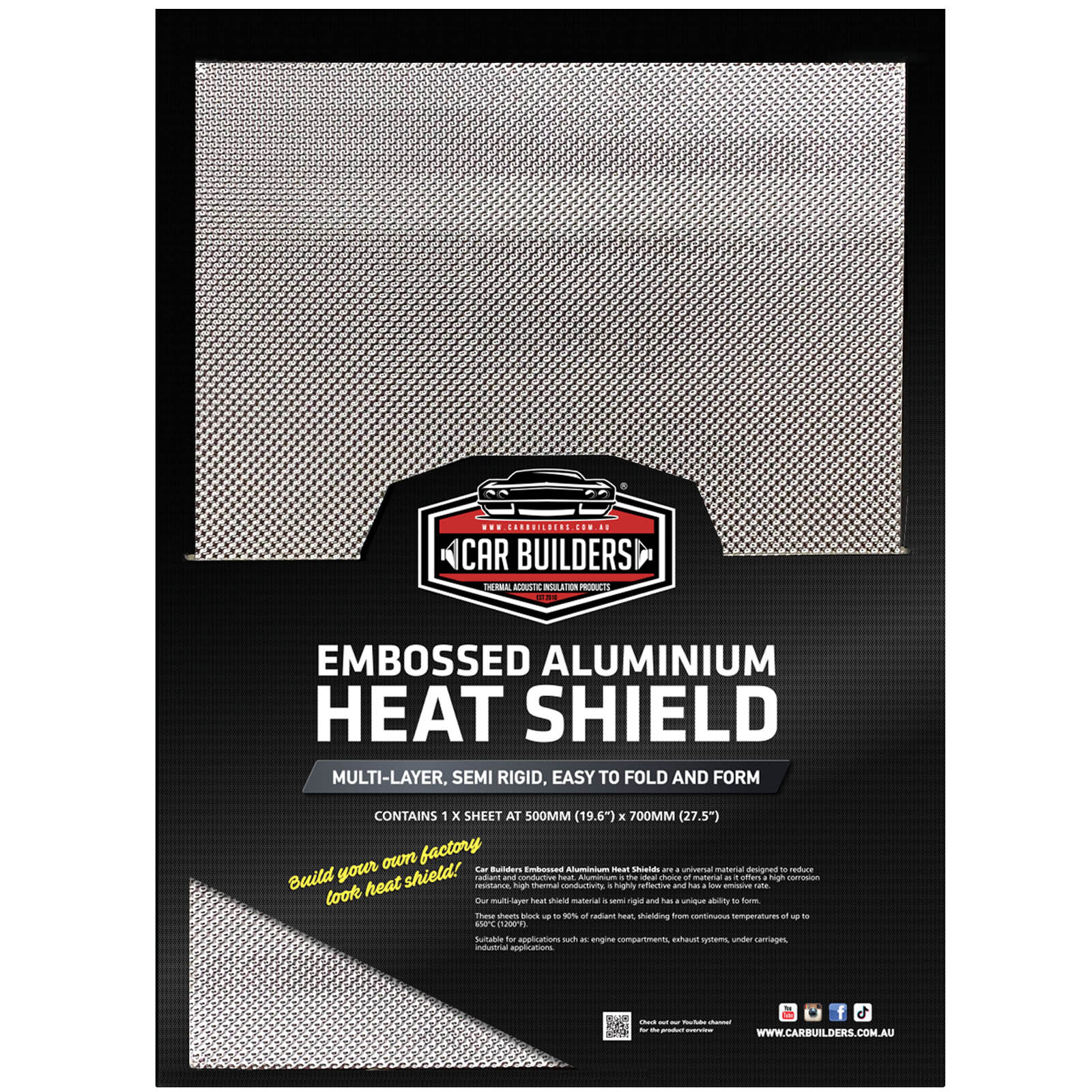

They definitely did a good job with the A/C cannister relocation - that's where I mounted my oil-catch can so was not an option for me
Suggestions:
* Heat-sheath that hose at 11 o'clock of the downpipe next time you do a coolant change
* Use heat-reflecting tape on the two A/C barbs (they WILL get hot and that blue plastic WILL melt)
* consider folding the heat reflective tape along the shelf edge too to protect the paint
Alternatively, make your turbo heat shield now that the A/C is sorted.
This stuff is great (available at SuperCheap, AutoBran and Repco):
Make the prototype out of a corrugated cardboard box since it has a similar thickness, then the 1st version - accumulate some origami skills to minimise cutting and get neat folds/curves.
You'll probably end up making a 2nd/3rd version as you find the deficiencies in your initial design and get better at working with the shielding.
Folding the outer edges will give the shield extra strength and you shouldn't need additional bracing with this stuff.

Those are good suggestions, and now that there's more room there it should be manageable. That shield material is what I was planning to use when I thought I could do it before the relocation. I might revisit that at some stage.
