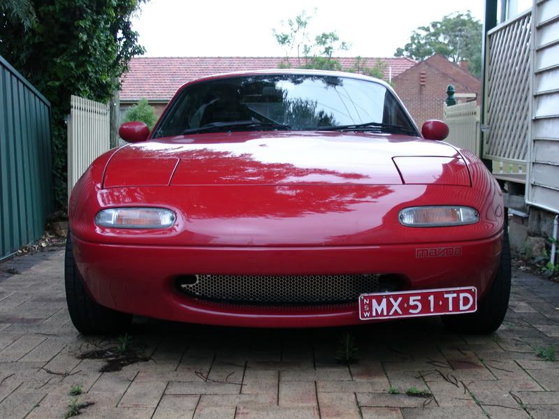

Specs for my pride and joy :D
1991 Classic Red NA6 (Aus Delivered)
Exterior:
Factory Hard Top (No Demister)
Brown Davis Rollbar - Black Powdercoated (CAMS Approved)
MX5 Plus Offset Number plate bracket
IL Motorsport Stainless Steel Grill
Interior:
Chrome Vent Rings (IL Motorsport)
Chrome Side Demister Vents (IL Motorsort)
Chrome Gearshift surround (IL Motorsport)
Chrome AC Knobs (IL Motorsport)
Artwork Dewa Instrument Cluster (picked them up from Japan off Dewasan himself - Super Rare)
Artwork Dewa AC Panel
Artwork Dewa Cigarette Lighter surround
Upgraded all interior illumination to Amber (to match cluster)

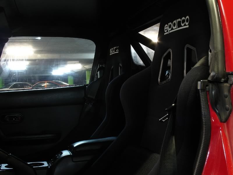

Sparco Sprint Seats (Driver and Passenger)
Nardi Classic 360mm Steering Wheel
Voodoo Magnum Pearl Gearknob
Sony Headunit with MP3 playback
Suspension:
Lovells Sports Springs
Mx5Mania Front and rear Chassis Braces

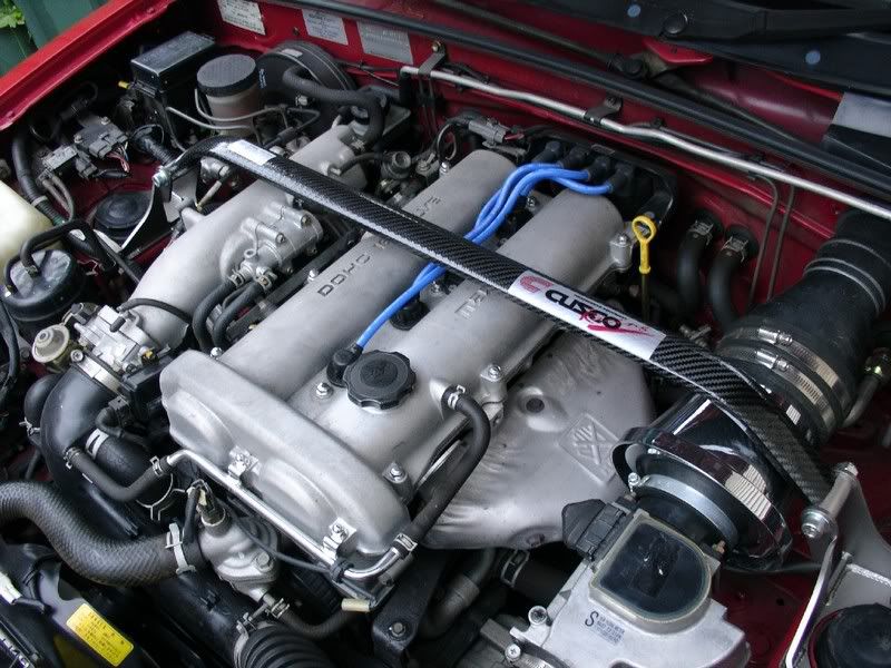

Engine Bay:
14 Degrees Timimg Bump
Cowl Cold Air Intake
Cusco Carbon Fibre Strut Brace
Wheels & Tyres:
Watanabe RS-8, 14x6.5 ET+14
Potenza G3 tyres

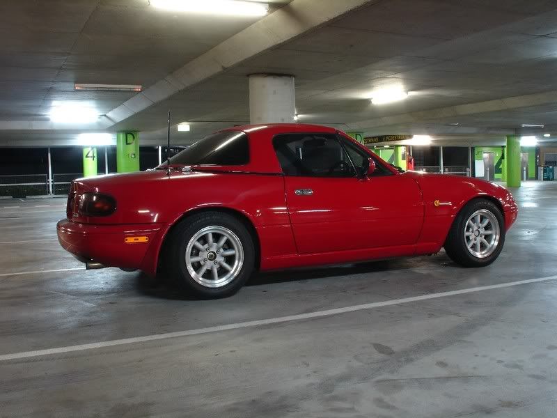

Postby RaYmO » Mon Feb 11, 2008 4:33 pm

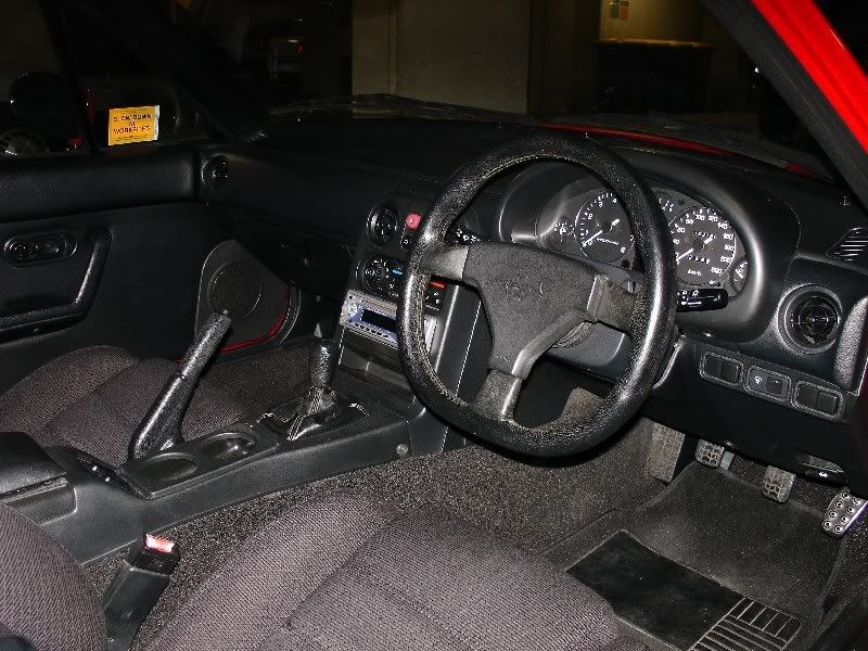

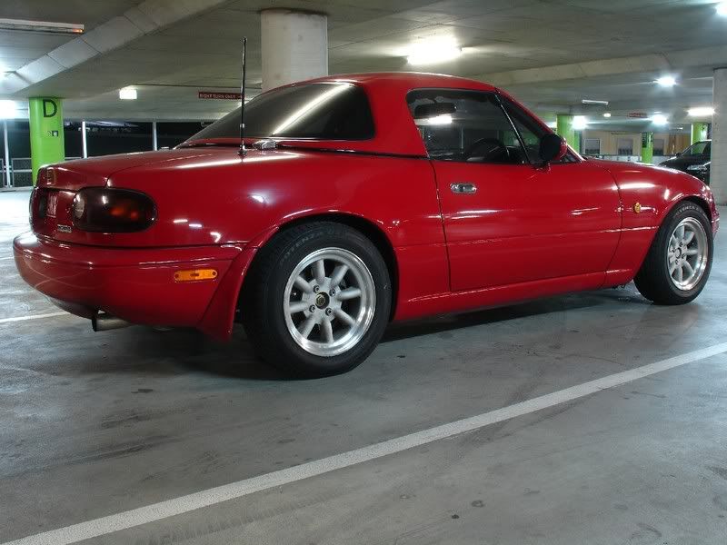

How my car looked when I purchased it:

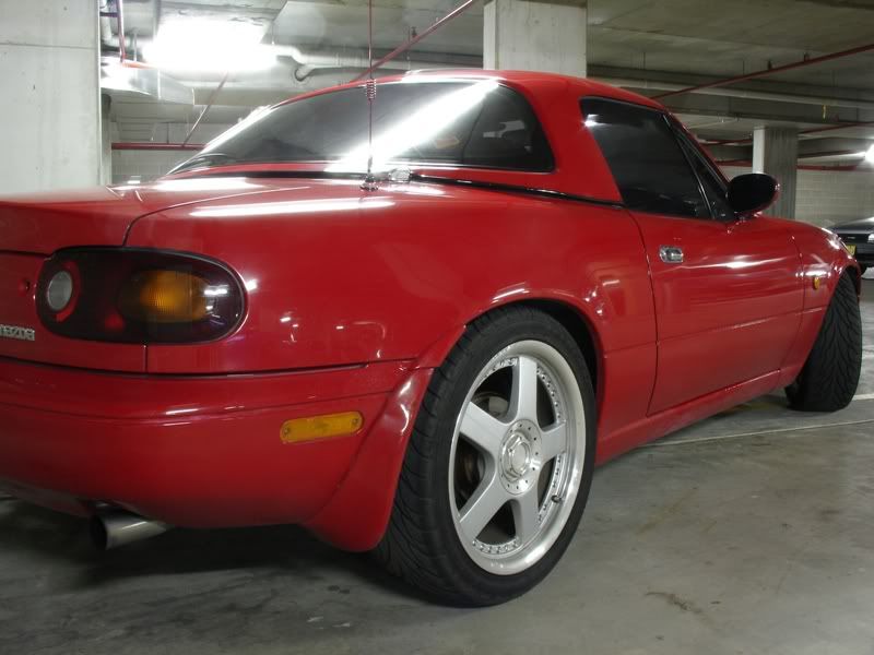

Postby RaYmO » Mon Feb 11, 2008 4:34 pm

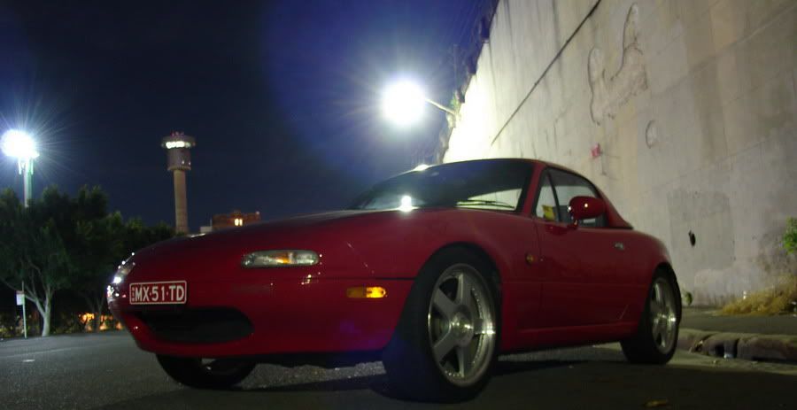

Then I changed the wheels for a more \"JDM\" look with TE37 knockoffs (with the correct stickers I might add :D)

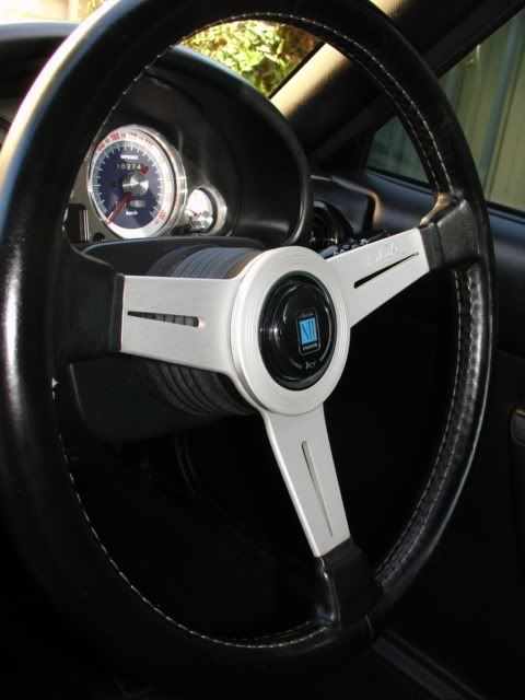

Steering Wheel: Nardi Classic 350mm
I picked this up for a steal on ebay... Paid $80 plus shipping from Japan!

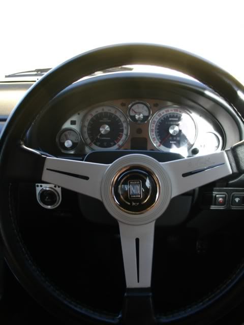

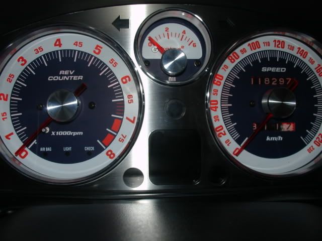

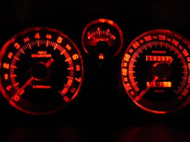

Artwork Dewa Gauges:
Custom gauges created by this dude in Japan... picked them up when I was over there in September 2006

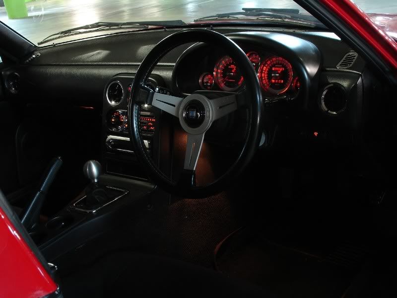

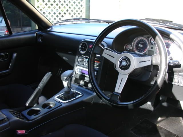

The problem with these gauges was that the red/orange illumination of the gauges... I had to change the lighting for the OEM parts to match... something that took me 6 months to find time to do. My interior was Red/Green/Blue for months but now all the OEM bits have been updated to match the Red lighting from the gauge... Just need to find a replacement head unit to match everything else.
Bling:
One of the first things I did to the interior was the lil chrome bits to break up the black interior... These included Chrome AC Vent Rings, Chrome Gear Shift Surround and a Chrome AC Panel.
Here's some before/after pics:
Here's how it all looks at night:

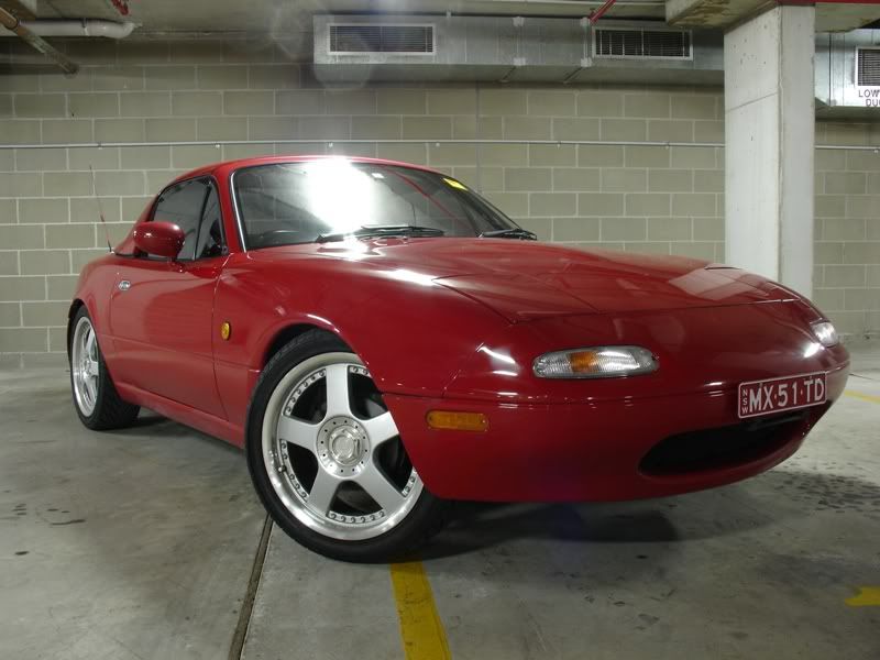

Postby RaYmO » Mon Feb 11, 2008 4:43 pm

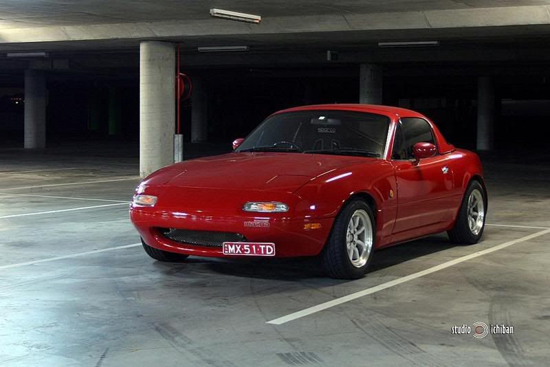

This is how the exterior looks for now:

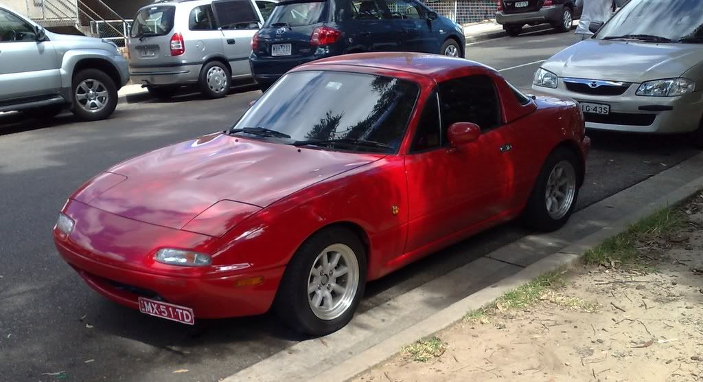

took some more pics recently...
And a couple more from other mates I met up with that same night

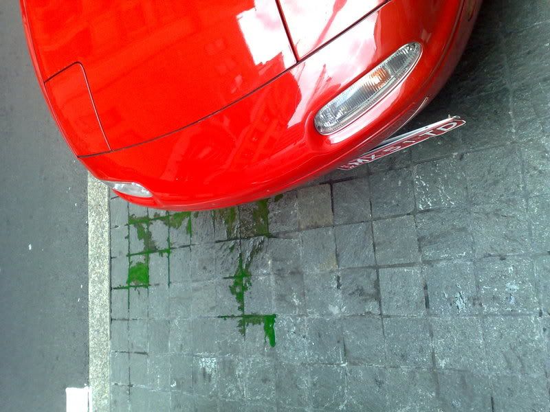

I took a day off on Tuesday and went over to MX5Mania once again to get them to check out my ride and also perform a 160k service. I have been checking the radiator/oil levels 2-3 times a day throughout the week to see if there is a leaking issue.
It wasn't until my car was on the hoist that you could see the leak.
Culprit was a $12 rubber seal at the Crank Angle Sensor. That was replaced as well as all the fluids and the car feels good as new (bar the rattles/squeaks :D)
