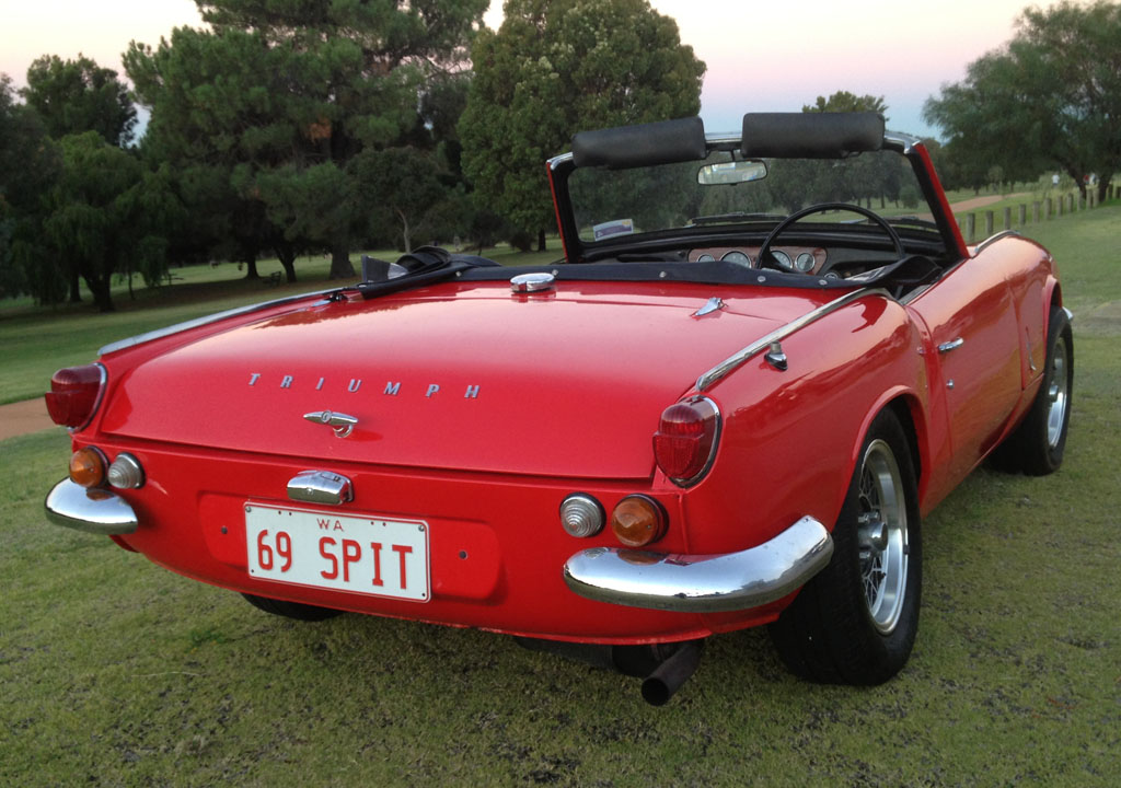

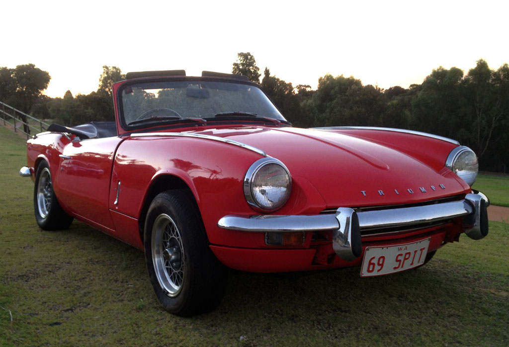

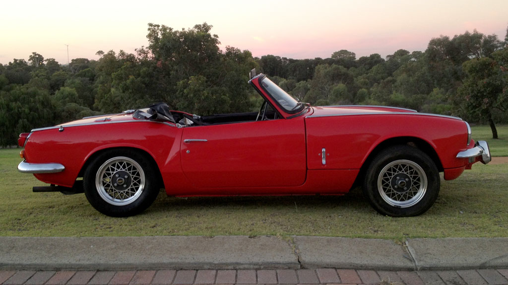

Since you play with classics, you might be interested in my Spitfire.
http://www.pixelculture.com/1_04_2013_Spitfire_04.jpg
http://www.pixelculture.com/1_04_2013_Spitfire_02.jpg
http://www.pixelculture.com/1_04_2013_Spitfire_03.jpg
- Dave.

Looks gorgeous in that dusk lighting.
The fuel filler cap is in a such unfortunate location.
