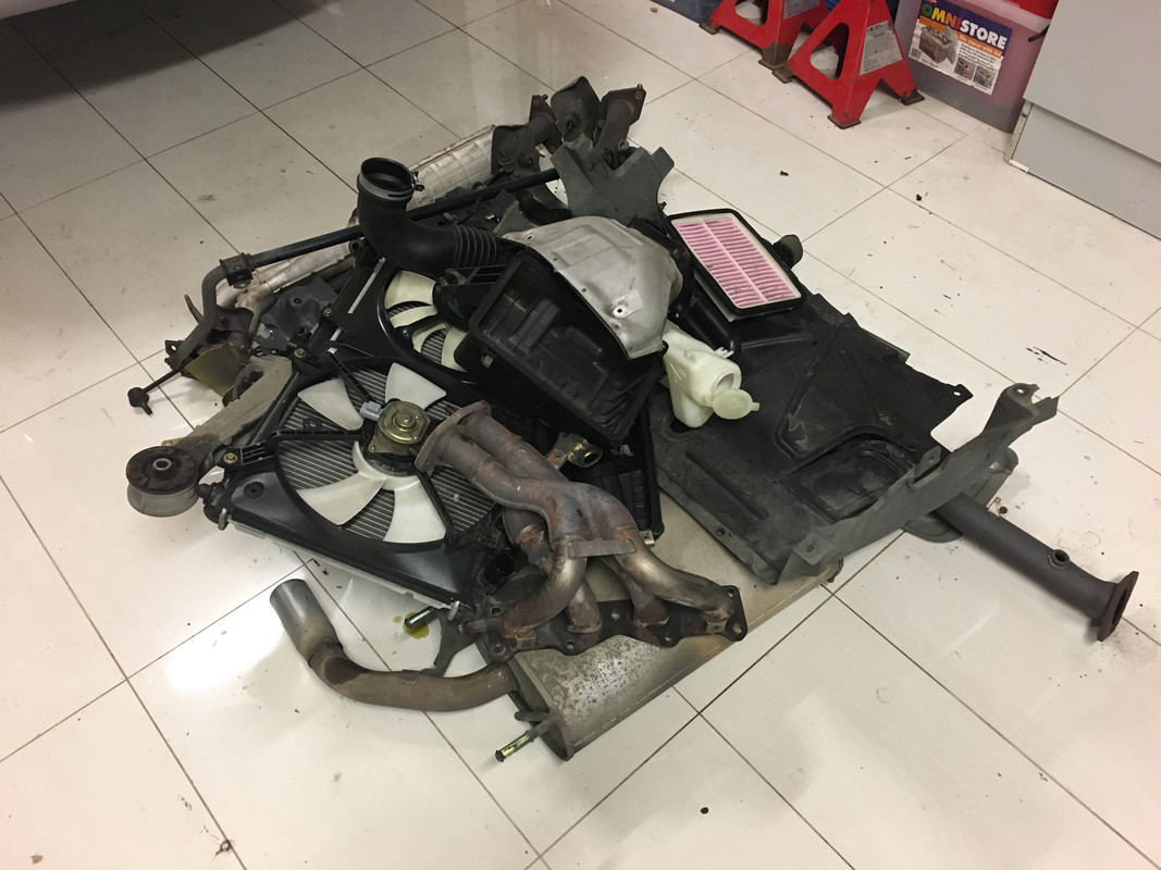

I was just working out what needs to be removed from the car so I can do it all in one go and not forget something. For a mildly modified track car the list is long.
Inside-
Steering wheel, airbags, under carpet rubber and seats.
Outside-
Softtop and maybe the bonnet.
Mechanical-
Radiator, fans, intake, exhaust and headers, front of motor for timing belt/water pump and seals, clutch, flywheel, diff, chassis braces, brake lines, brake pads, rotors?, wheels and all fluids.
Should take a full day at least. And maybe the whole A/C system as well as the P/S pump and brackets. But this can be done later.
Everything has been ordered, and should be here in the next week or so. In the mean time I will throw it on the hoist and remove the parts listed above.

It started as a garage cleaning day, but after I put oem wheels and suspension on the carbon fibre MX5, it could come off the hoist. Then the silver MX5 went on the hoist, and I started pulling off all the bits I don't need. Did the diff swap, and started stripping the motor so I can put new seals, timing belt, etc on. Next was clean up the rocker cover, I grabbed the wrong can of paint, it was supposed to be wrinkle red, but I accidentally picked up Holden red engine enamel. Probably looks better.
Still a lot of work to go..
Not looking forward to doing the clutch, I hate taking off the gearbox.
