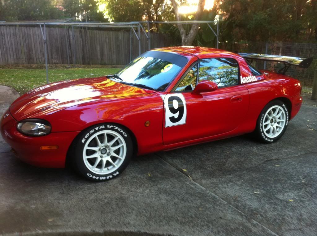

Yes I've done exactly that, boot mounted with no apparent issue. I felt the same as you but it was too much trouble and money to do it the "proper way".
So if the front runners are boot mounting theirs why are you concerned. It may distort the boot eventually but better than cutting it up. It was hard enough for me to drill 4 holes in a perfect boot but does look the goods when done.

ja9 wrote:Yes I've done exactly that, boot mounted with no apparent issue. I felt the same as you but it was too much trouble and money to do it the "proper way".
thanks ja9,
Nice to hear you have done it with no issues. What AOA are you running?
I was/am concerned cos many suggest that it's a recipe for disaster, and was wondering if there was underboot bracing or similar, and hence why i'm wanting to hear from those that have successfully done it.

I have a CF wing on my track car, which looks very similar to one on Ja9's car.
It has 4 bolts through the boot and is positioned so that 2 of those bolts pass through both the boot lid and the bracing. There are no other mods to the boot lid.
There was some deformation of the boot lid surface when the wing was fitted and tightened down, but no obvious change since then.
The wing is set to 4 degrees, relative to flat ground.
The car has a mostly stock 1.8 and doesn't see over 180 km/h at any of the local tracks.
Note one inconvenience is that with the wing fitted the boot lid will no longer stay open, even though I have used cable ties to tighten the springs.

M1474 wrote:What wing is that ja9?
No sure as it came with the car. It maybe the same as the ones sold by Mx5 Mania.
I started off running approx 9 degrees AOA at SMP South and had no issue with understeer but when I went to WP there was a huge amount of understeer. So I backed it off to < 1 degree and made some small adjustments to the coilovers and now everything works well.
